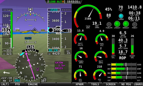

FWIW I installed a shunt to measure the current going in/out of the battery (Postion A) and used this Hall Effect Sensor to measure current going in to the instrument panel (Postion C). If I want to know the total current from the alternator, just add the two values (Kirchhoff's law).
In this photo you can see the aircraft load (PANEL) is 16A, the battery load (BATT) is 2A so the total current from the alternator is 18A.
BTW; the DYNON EMS already has the configuration files for both CS-01 (100A) and CS-02 (50A) Hall Effect Sensors. :cool:
