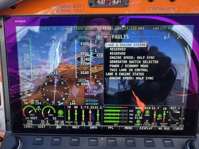

I have this indication on the faults page, engine is running perfect. Rotax does not know the reason behind. Any idea?
Mine has always shown the same thing now for five years. I thinkit’s got to do with the redundancy in the Rotax 912iS engine, at least that’s what I’ve always contributed it to.
