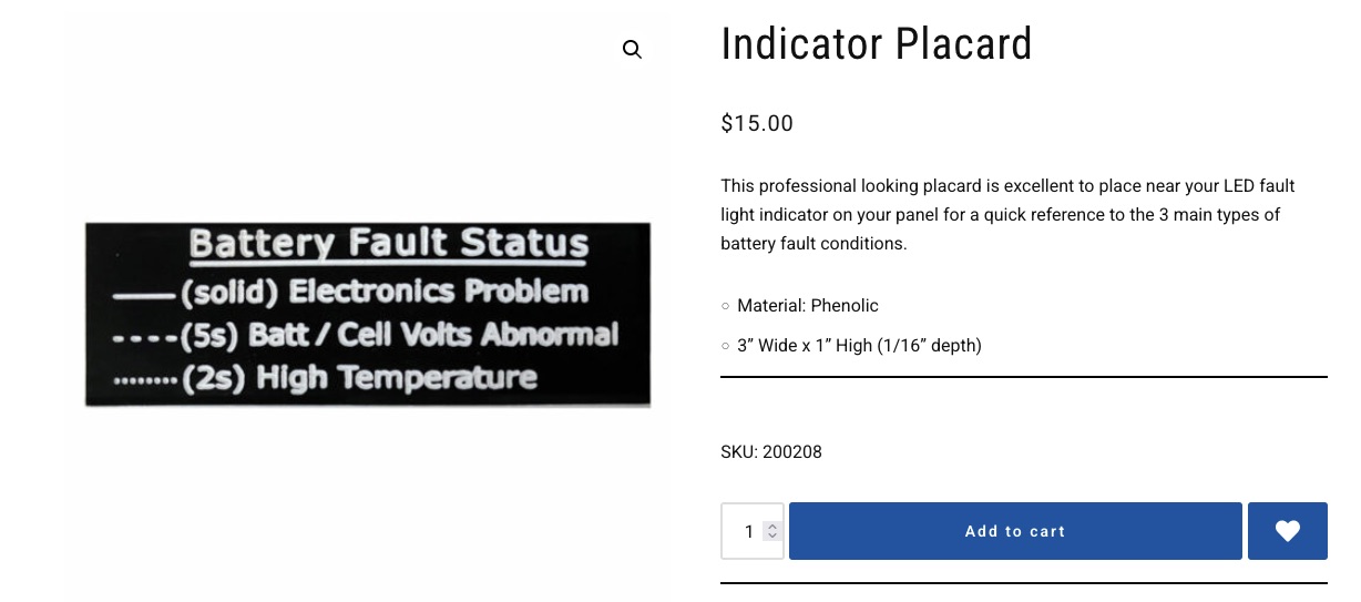

soarhead
Mar 2, 2021
53
According to EarthX, the lead from the battery monitors voltage not temperature. When battery drops to 12.5v it sends a signal that will light an led if connected. I would like to monitor temperature to make sure the battery stays healthy. Below 140F is the goal. Some builders install a blast tube, others don’t and report temps within range, but I’m going belt and suspenders.
The BMS monitors Voltage, Temp and cell balancing. You can even purchase this decal from Earth-X
