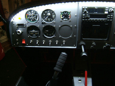

I installed blue strip LED's with a dimmer. The only problem I have experienced is that the lights go out when I key the x-mitter.
I'm sure there is some way to fix that but I haven't found it that annoying.

Looks good - very even lighting on both sides of your panel.
Is the LED strip powered from the same circuit or wire that also powers your 2-way radio?
On the *bright* side (pun intended), you now get visual confirmation whenever your radio is transmitting!

No, the LED's are on their own separate circuit.
Your observation about verifying the radio reflected my own.

I could but I don't find it annoying enough to try to troubleshoot. I have found some reference that the RF may be causing the problem with similar problems with LED's.
