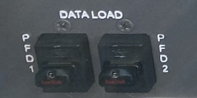

There are some unexplained anomolys. A friend got a San Disk Ultra Fit 32 GB, USB 3.1. It caused boot problems on both the Classic screen in his Kitfox, and the HDX in his RV-8. I exchanged him identical Ultra Fit I was using with my 2 Classic screens, and his drive works fine in my plane, and the one I gave him works fine in his planes. The only suggestion I have seen that might be involved is to NOT format them with the Seattle Avionics app. Either leave them alone, or reformat with Windows, and then manually add the SkyviewUSA folder that is required. You only need 16GB to hold all charts for lower 48 states.Sorry for the late reply. I purchased one Lexar 32GM, USB 3.1 and one PNY 64GM, USB 3.1 and both work fine. Both are very small, like in the picture Eugr posted. Who would have thought that an the older technology USB would work better...

Eugr: where did you buy the panel mounted USB ports that connect to the Dynon system? I'm still planning my Dynon system trying to figure out where I source everything and what I need to source. thanks!
