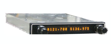

Have very limited space on my panel:
3652
I think a VAL NAV 2000 May actually fit in the lower left hand corner.
Has anyone here integrated a VAL NAV2000 with their Skyview?
If so, how did it go?
Thank you!
Yes. Pretty straightforward and nicely emulates the Garmin SL-30 (with one exception: no automatic Morse ID).
3667
It fits in a standard-width avionics rack and connects to power, a SkyView serial port, the audio panel, and an antenna. Of course, the serial port has to be configured correctly in the SkyView setup.

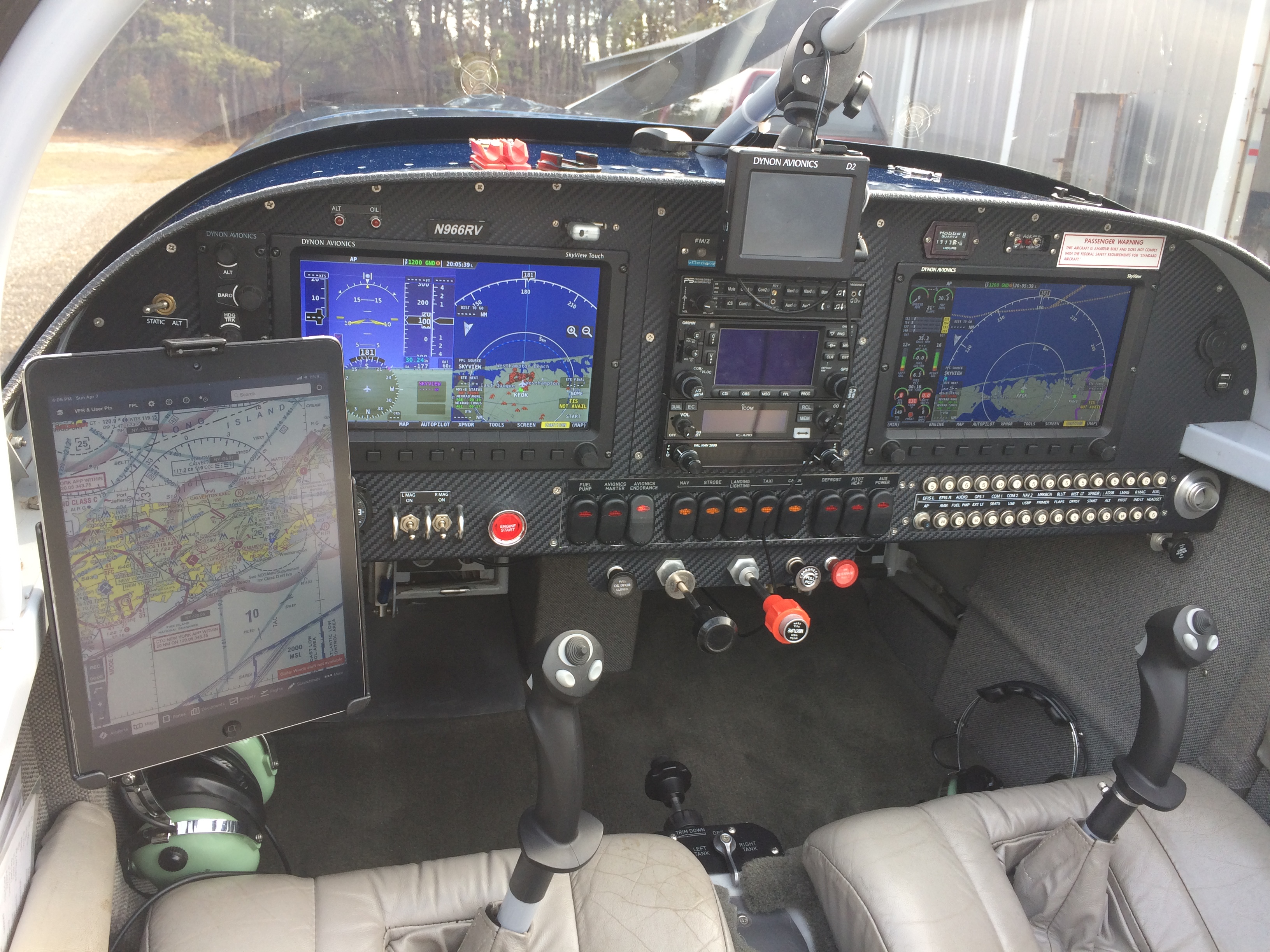

Does Skyview display ILS glideslope?
Yes. Here's a screen capture showing the autopilot flying the aircraft on course and on GS, just inside the FAF.
3668
