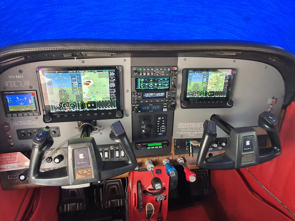

The HDX power needs to come on with the aircraft master. If you install a second screen, you can put this on the avionics bus if you wish.
I have done a 182, and put both the screens on the battery master. The autopilot, transponder, radio's etc on the avionics bus.
You will need a magnetometer. I mounted mine in the RH wing just outboard of the fuel tank.
I made a bracket for it that mounts it to a rib just near an access panel. It works well out here.
I have always just used the photocell dimming of the screens and adjusted the levels to suit.
Yes, the alternator inop output from the voltage regulator can be connected to a general purpose input of the HDX. When I get some time I'll look up what you need. I'm pretty sure the inop output just puts a ground signal out when the alternator is not producing.
Most of your gear (EMS, backup battery, ADS-B, ARINC, etc) will mount to the 503039-000 avionics shelf tray that mounts to the forward side of the screen. Yes it all fits behind the panel, but you have to take a fair bit of care that you don't foul the yoke components. It's pretty close with a 10" screen.

Is there room in the radio stack for the COM panel, knob panel and AP panel side-by-side?
GKC Aviation
Oct 4, 2020
171
You would get three side by side.
The Com, AP and Knob panels are 42mm wide. From memory, the radio rack usable width is about 160mm.
