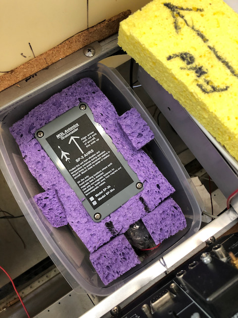

Well, here's one way *not* to do it. Yes, this was actually someone's installation, found by someone over at VAF during an inspection...
