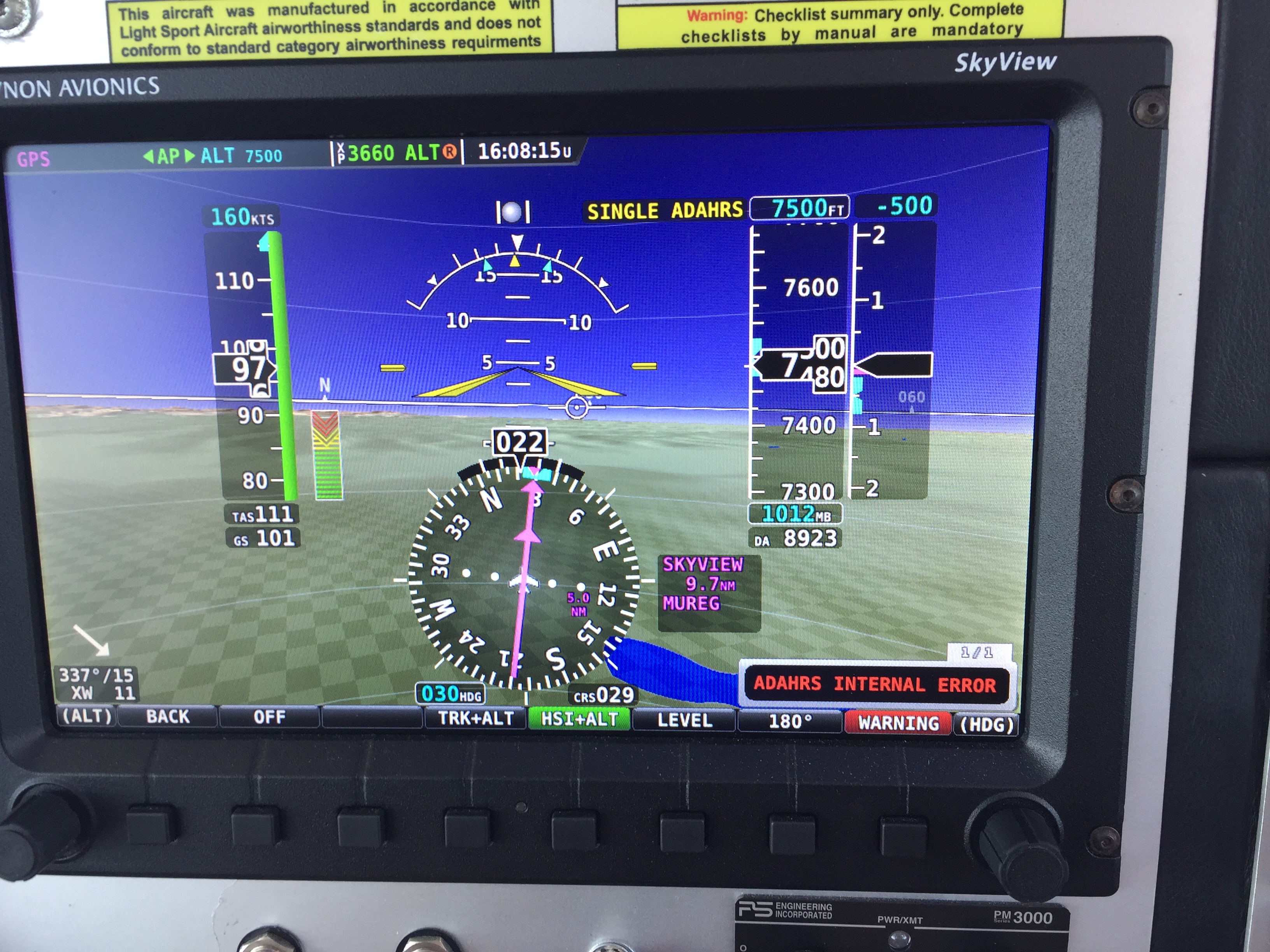

I got this warning yesterday, does not go off when cycling avionics: ADAHRS Internal Error + Single ADAHRS. Besides the error message everything works (I have a dual system). I assume this maybe actually a software problem. Can you advice steps how to fix it?I have CTLS Jubilee, no analog backup. Not sure if it is safe to fly to check this at the service? Thanks for advice!

This means that your aircraft has multiple (2, in your case) ADAHRS installed, and one of them is not working properly. This is not likely to be a software problem. You should get in touch with your Flight Design service center for further help with this issue.
