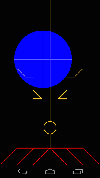

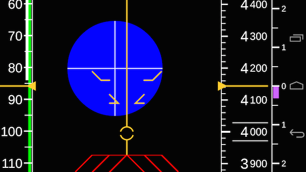

Hi folks,
I would like to introduce you to a project I've been working on for a while, which I call Airball. It is a new visualization of AoA, IAS and sideslip angle, per the attached images.
I have implemented this as an Android app, and have flight tested it using RS-232 data from the Dynon D10A on my friend's RV-9A, N42PE.
The basic concept is an argument that, for light-sport aviation and similar pursuits, at least during certain phases of flight, the air data is the single most important thing. The Airball display shows the entire relative wind velocity vector as one integrated "digital yaw string".
To get an adequate approximation of sideslip angle, one need merely scale the ball signal (lateral acceleration) by the dynamic pressure. This recovers the sensitivity at low IAS that an actual yaw string provides.
The AoA display is annotated with symbology for alpha-X, alpha-Y and alpha-Ref, to aid with precision flight.
I really hope Dynon can incorporate this idea, or some derivative of it, into your PFD. I think it would greatly enhance flight training and students' ability to visualize how they "fly the wing", and I really hope a display like this can reduce the number of stall/spin accidents we unfortunately continue to see.
I'd be happy to work with you folks to get the Android demos running for you. The code is Open Source; see the links below.

Wow, I admire your creativity. I have been studying alternative ways to display information and this is a good example. People are resistant to change, however, so this would be best implemented as an adjunct display, perhaps replacing a standard aoa indicator.
I am an IOS guy, so I can't play with this directly, but I have a graphics display box that interprets the Dynon serial stream and allows me to represent data in any format so that I can play with displaying info in different formats and flight test it.
Nice.
