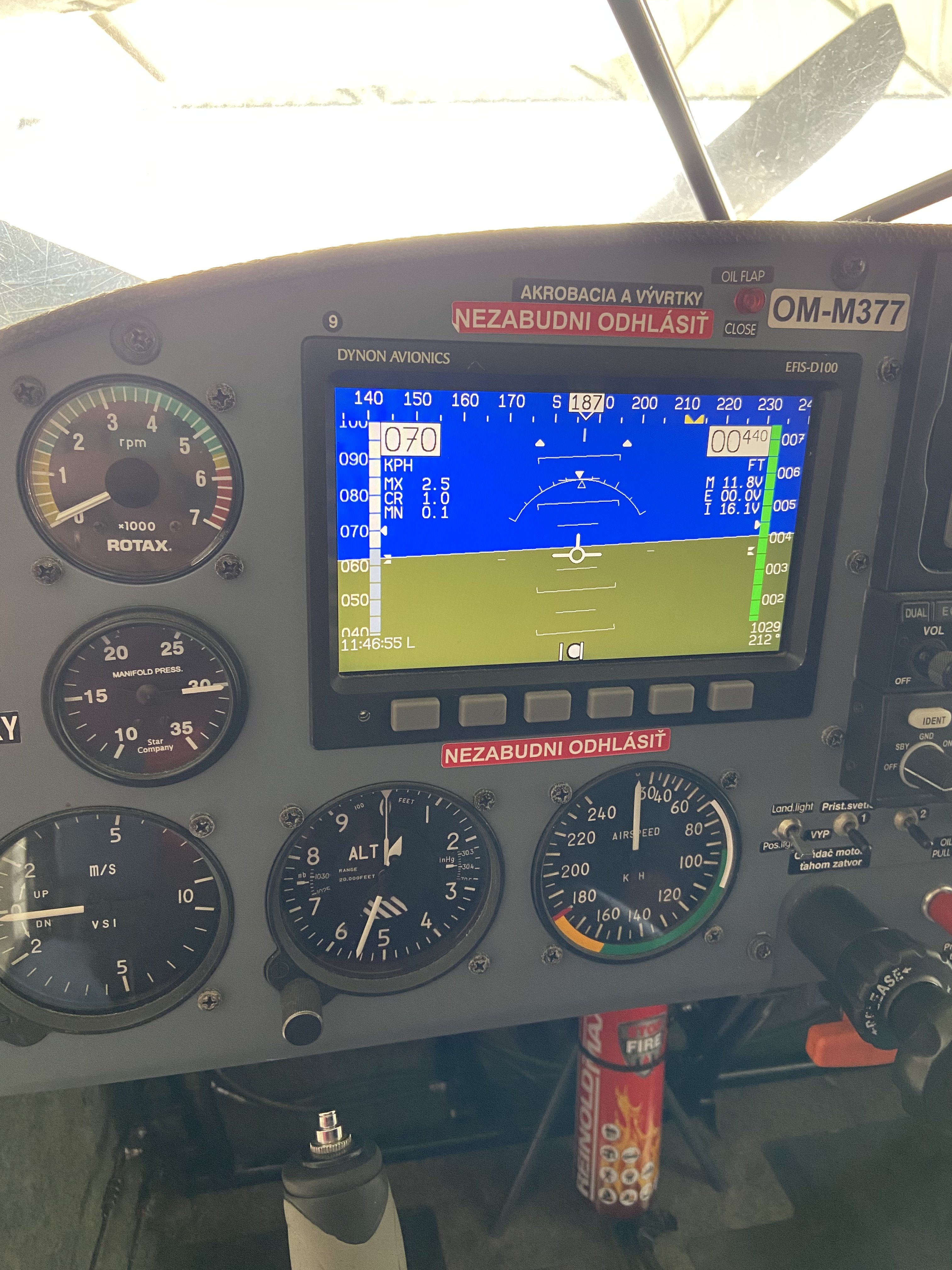

Hi guys, i have a problem with the EFIS-D100 - the speeds do not agree with the steam gauge- on ground when stationary it shows 70km/h, and when airborne the speed difference is only (almost exactly) 20km/h more than the steam gauge. Any ideas? My mechanic tried checking the pitot tube-seems fine.
Thank you,
All the best
ZE
You can try the zero pressure adjustment (covered in the installation manual). But if that doesn't fix it, we may need to take a look at it.

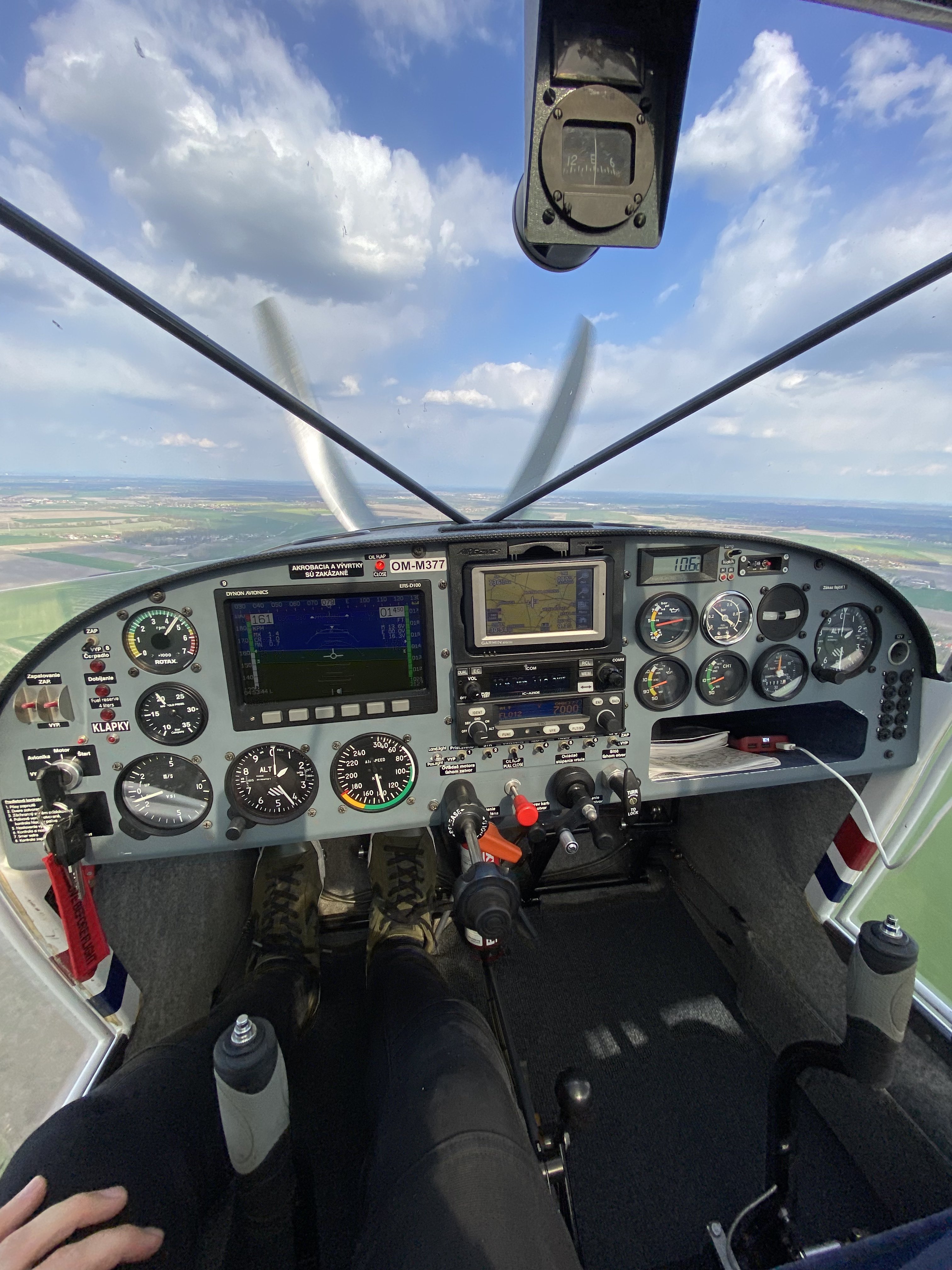

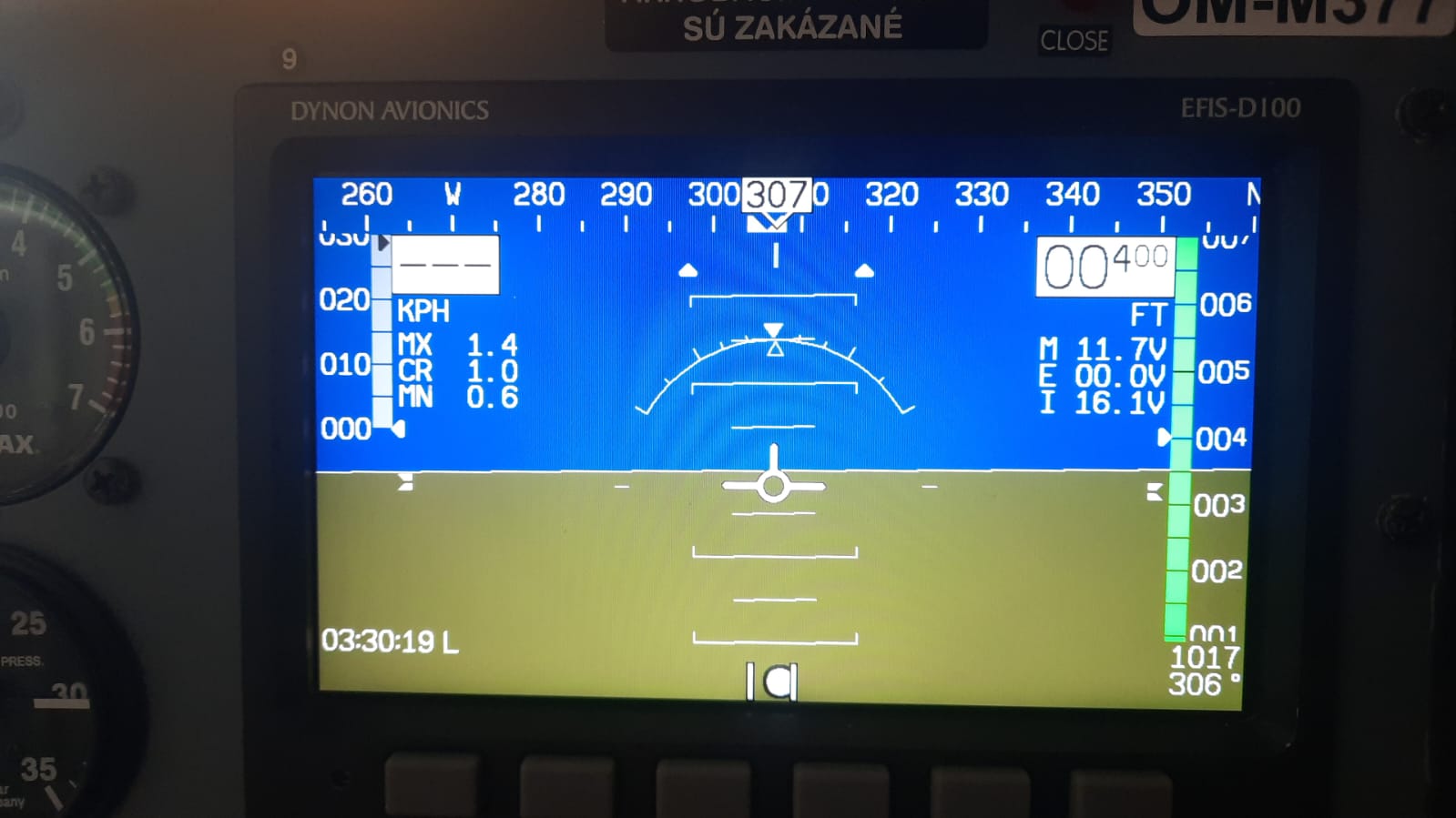

On the ground it appears that your advice worked! Thank you. Let´s see if it shows ok in the air..
