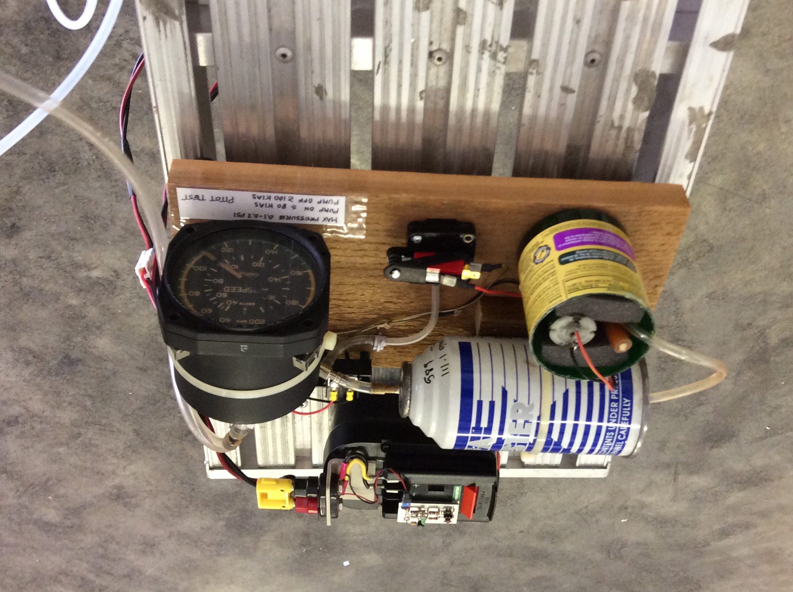

My buddy made a pitot static device to check my AHRS and pitot lines.The AHRS was working properly, we keep unhooking fittings until we found the one that was leaking. A 90 bend was leaking at the pitot.
I'm very fortunate to have a friend who is a retired avoinoics engineer. Be sure to look at the attached photo. The pressure used was between .1- .2 psi. Amazing!
Thanks for the help and comments. My airspeed is working now.
