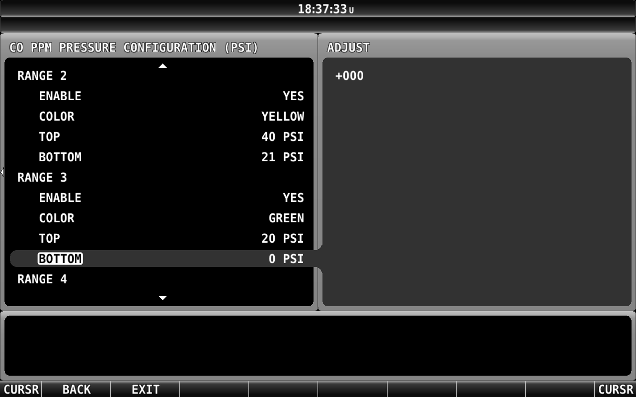

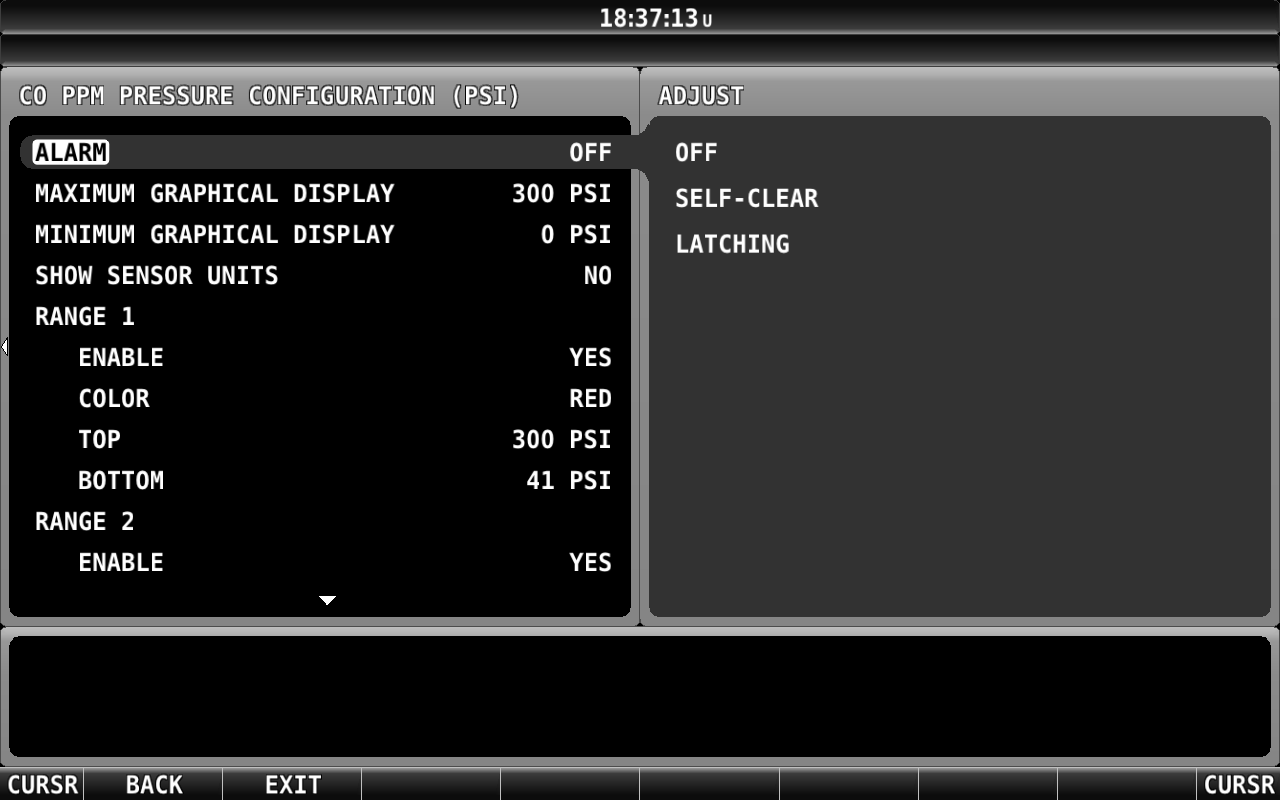

You need to use one of the enhanced inputs. This is an analogue input.
They are Pin 8, 22, 23, or 31 on the EMS 37 Pin connector.
Set up the widget as follows. EXCEPT.....Make it SELF-CLEAR, because you want the warning to alert you. Not off.
You can use any style you like. I prefer just the raw data number but you may want a dial or bar indicator.
