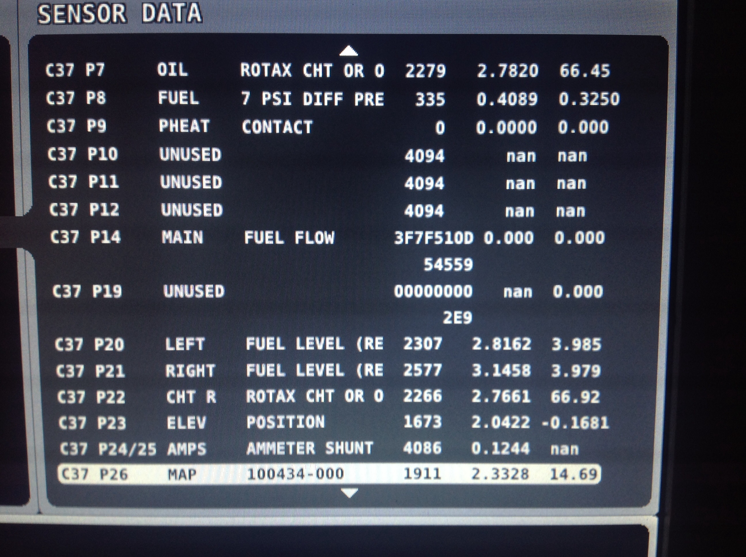

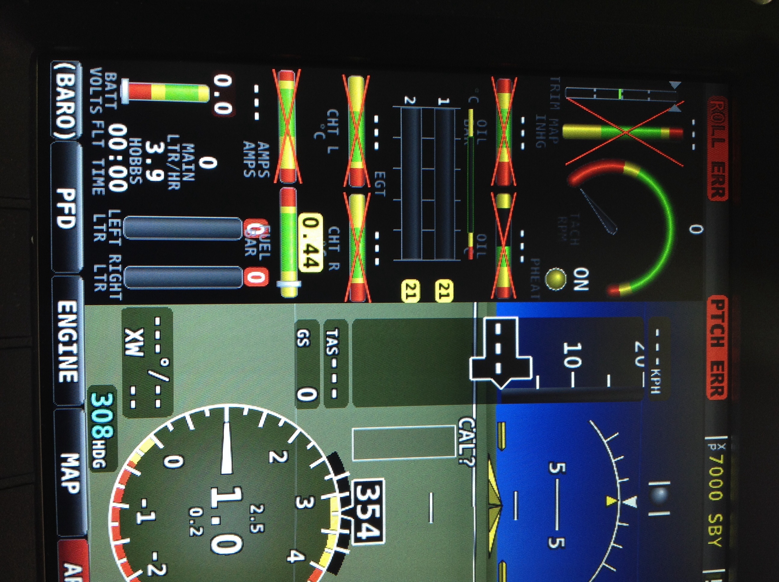

Display - amps not working
Shark_peki
Jan 5, 2014
16

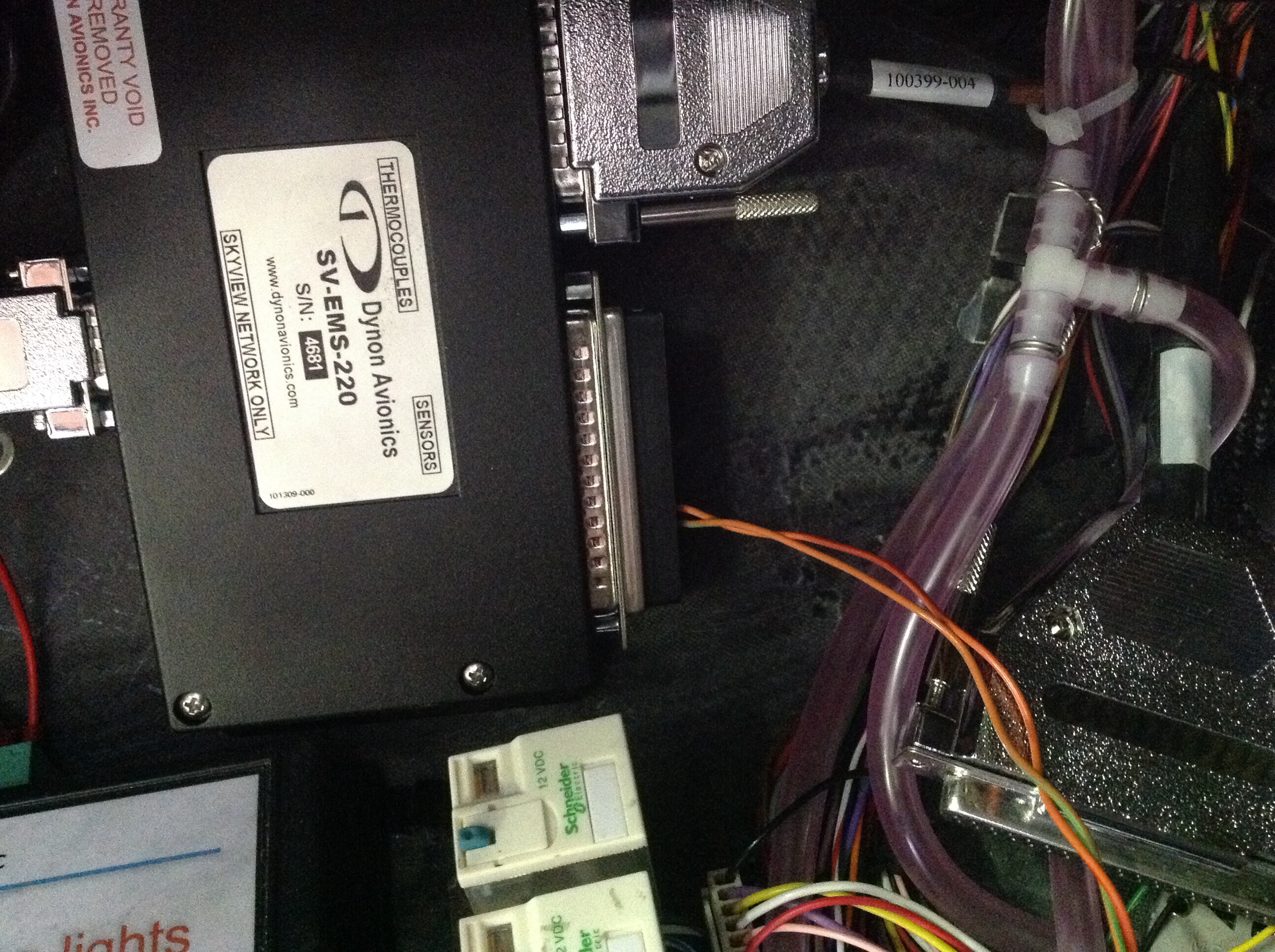

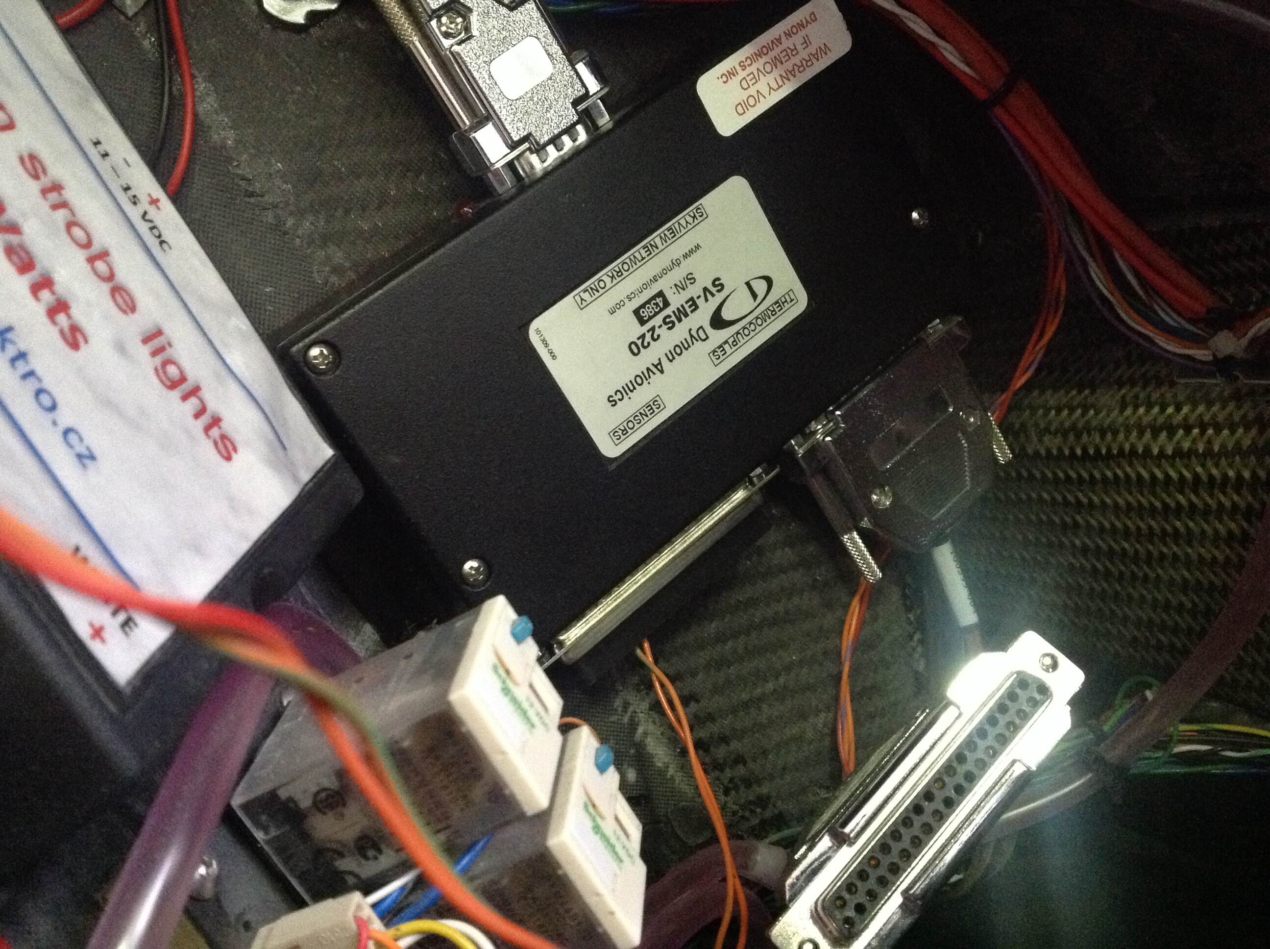

Result : both EMS have dead Amps reading. We think if we can do something bad, and we kill it. We found no way how to do it. Only possibility is that shunt is wrong, and it increase ohms from 0,001 to something significantly bigger, then current goes to sensor and can kill EMS sensor. But shunt must be really ill.
Shark_peki
Jan 5, 2014
16
Next steps : we take new EMS from just installed to new Shark, connect to this ill Shark, and will use just this shortcut connector. If everything will be OK, we will change shunt as well and make final instalation. Will check everything step by step, and report.

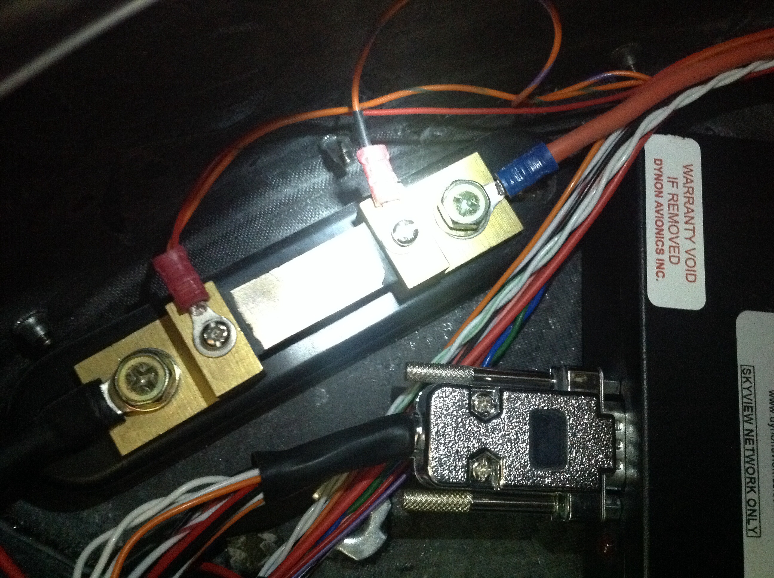

Do you have two wires coming out of the PIDG connector on one of side of the shunt (the left, in the photo above)?

Steve made a good observation. If you have confused the 2 orange with blue tracers you have no shunt in circuit but whatever is connected to the other wire orange blue wire would not care. Since the shunt is almost bullet proof, you may very well have mixed these two wires. Otherwise the EMS module, more likely than the shunt but I vote for mis wired.

An ammeter shunt typically produces 1 mv per amp. Not certain what Dynon uses possibly they can weigh in. If you take a 1000 ohm resistor and a 10 ohm resistor in series across a 1.5 V battery you will generate ~15 mv across the 10 ohm resistor. Connect the ends of the 10 ohm to the ammeter inputs of the EMS and you should see 15A on the Skyview.
Note that the shunt is a .001 ohm resistor to give 1 mv per amp, if you didn't disconnect the shunt prior to checking the continuity of the wires it would be good to do so. If you test between the wires at the EMS with the shunt in place it will look like a dead short.

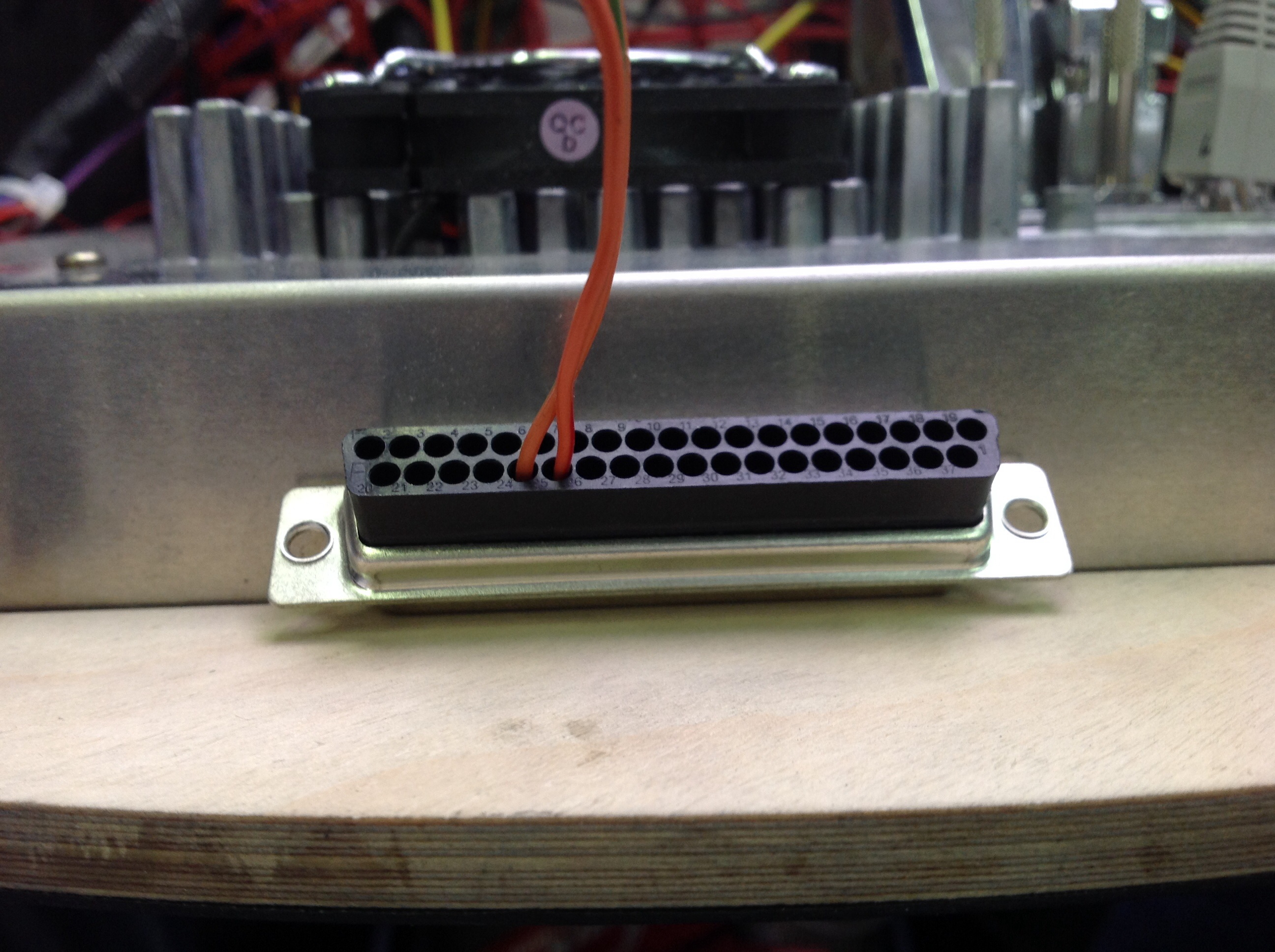

To be clear - when you're shorting pin 24 to pin 25, there should be no connection to the shunt at that moment. take the two wires from the EMS (from pins 24/25) that normally connect to the shunt screws, completely disconnect them from the shunt, and then connect them together. This creates zero voltage between them, and should yield a 0 A reading on the EMS.
