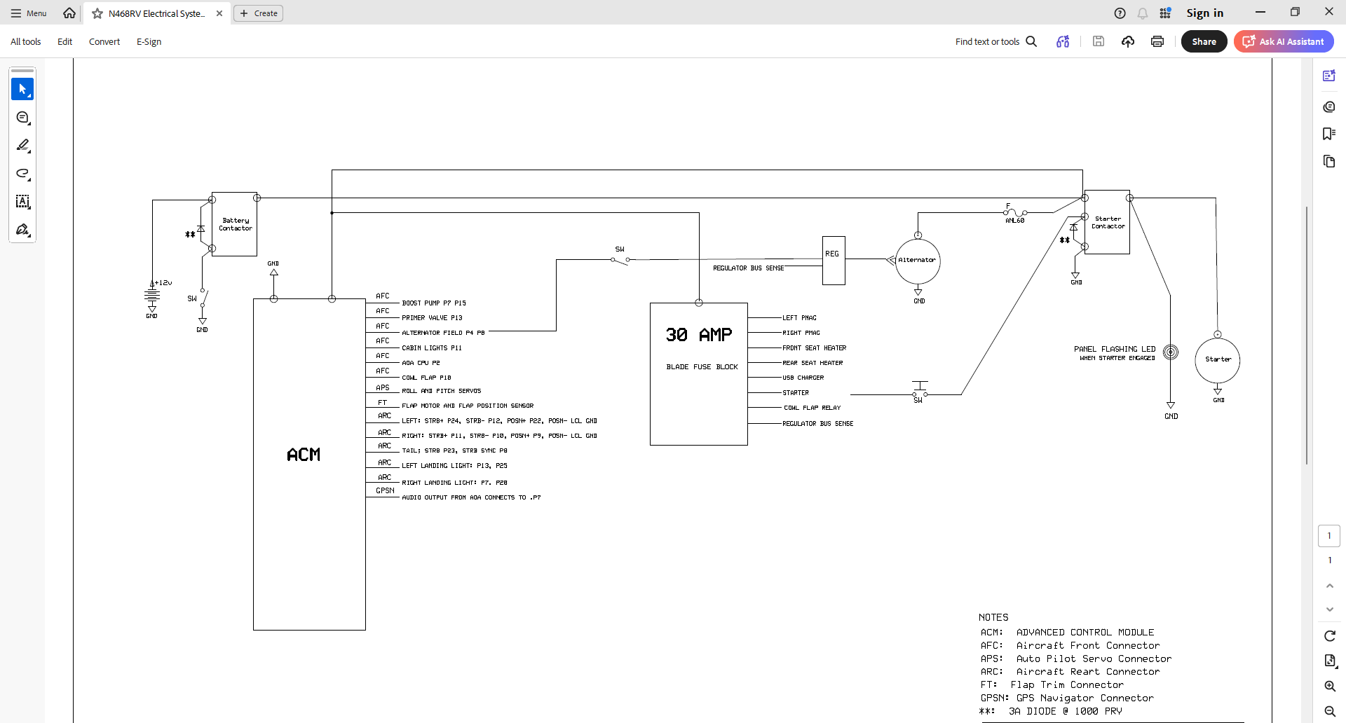

Push to start is a very simple low voltage circuit that activates the starter solenoid as drawn in the diagram below which also shows an optional LED that flashes when the starter is engaged. The key switch, or alternatively toggle switches, are used to manage the state of your ignition P-leads.

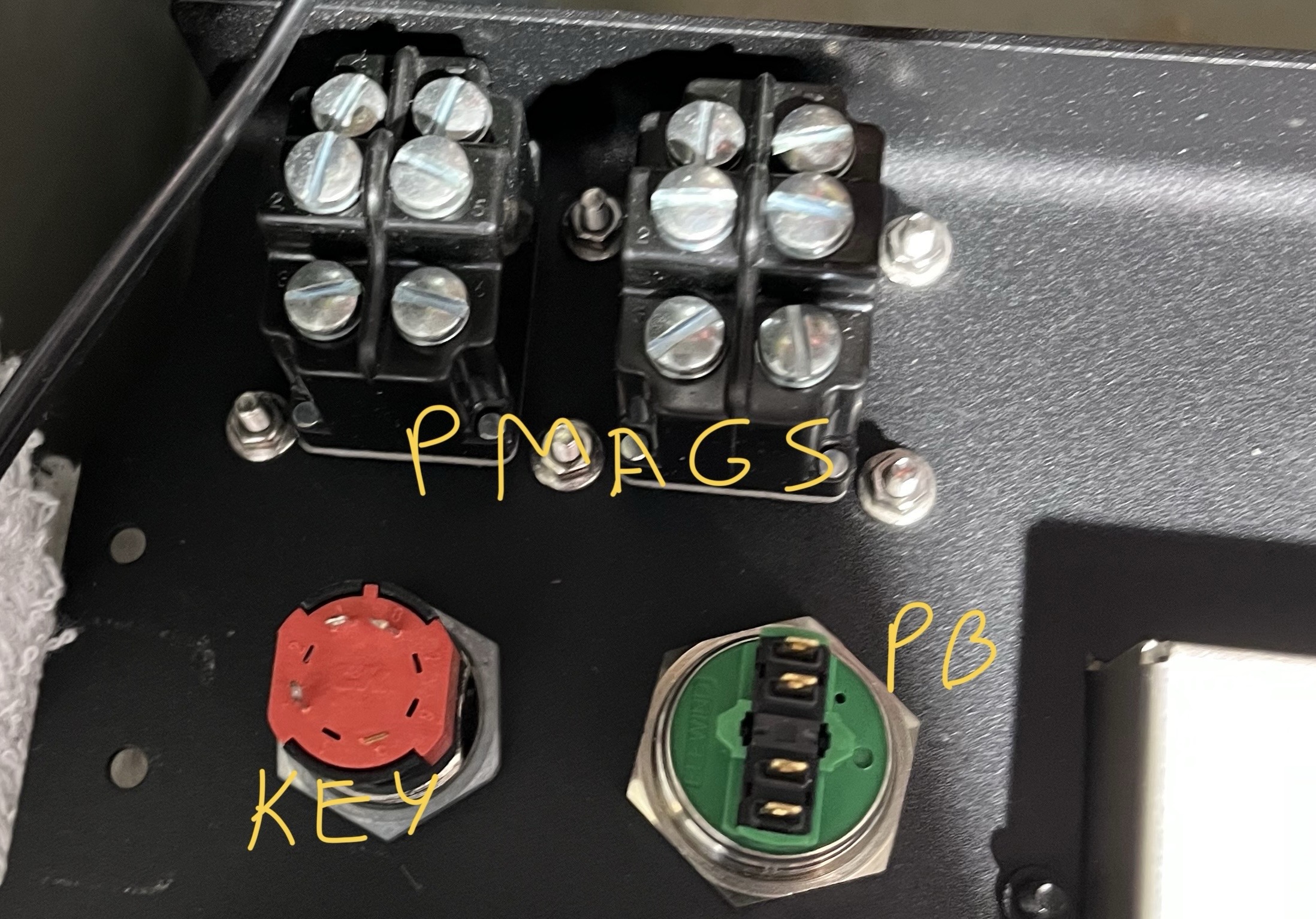

This is what I’m dealing with i may have to just get in there with a multi-meter.
Yikes! That is anything but intuitive.
Dual PMAGS, if you haven't already, download the PMAG schematics from https://emagair.com/ to map out how PMAGs are powered, grounded, placed into setup mode, configured for different timing curves, etc........ Lots of ways to do it and lots of ways to screw up.

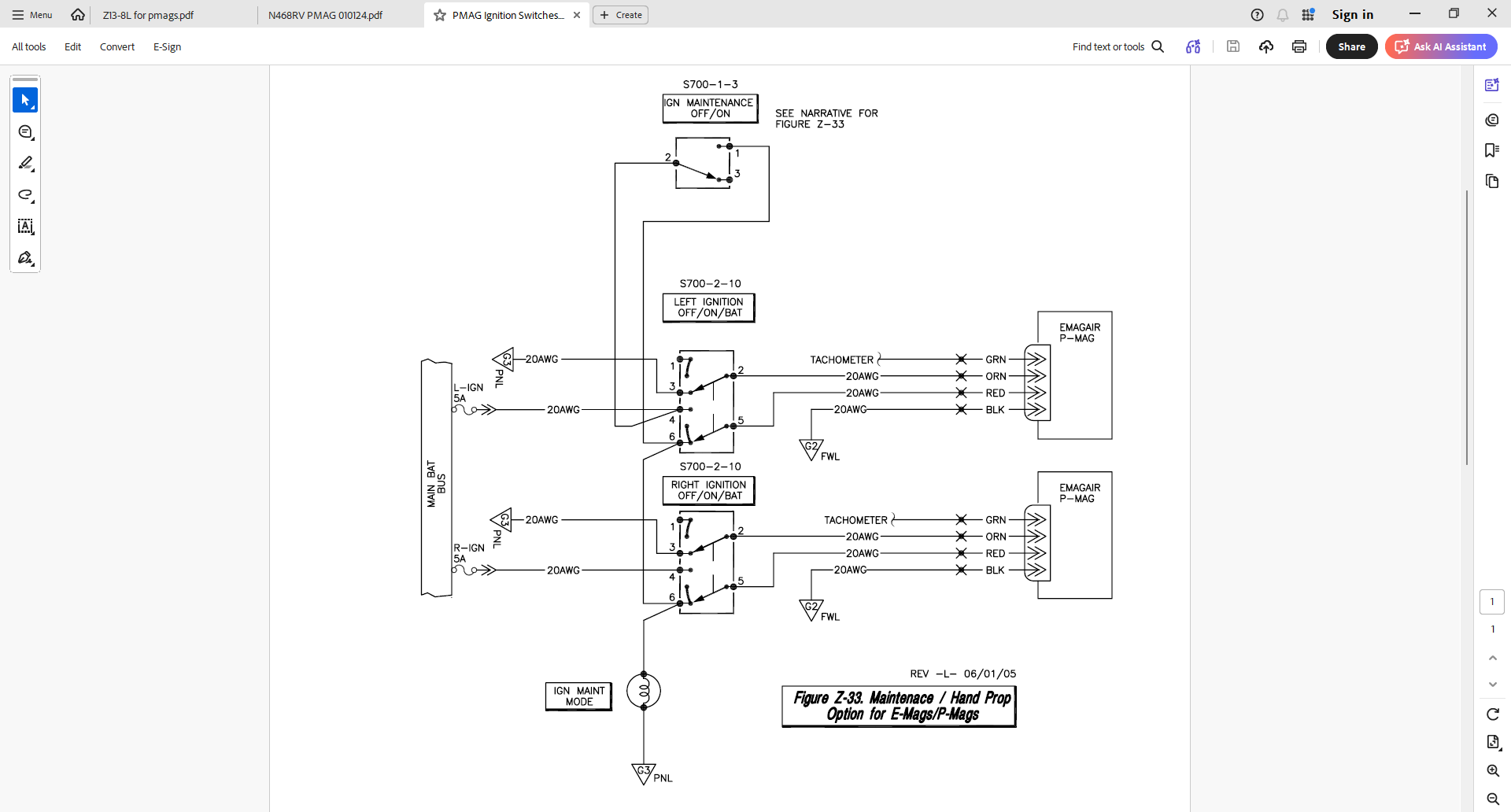

Here is a popular example from Bob Knuckols @ Aeroelectric.com showing how to use two S700-2-10 switches. Note that there is one error in the diagram. Since the PMAGS are self-powered above 900 RPM, the ground wire for the PMAGS needs to be grounded to the engine case, not the firewall.

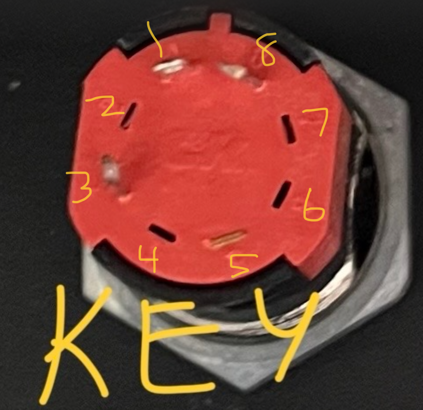

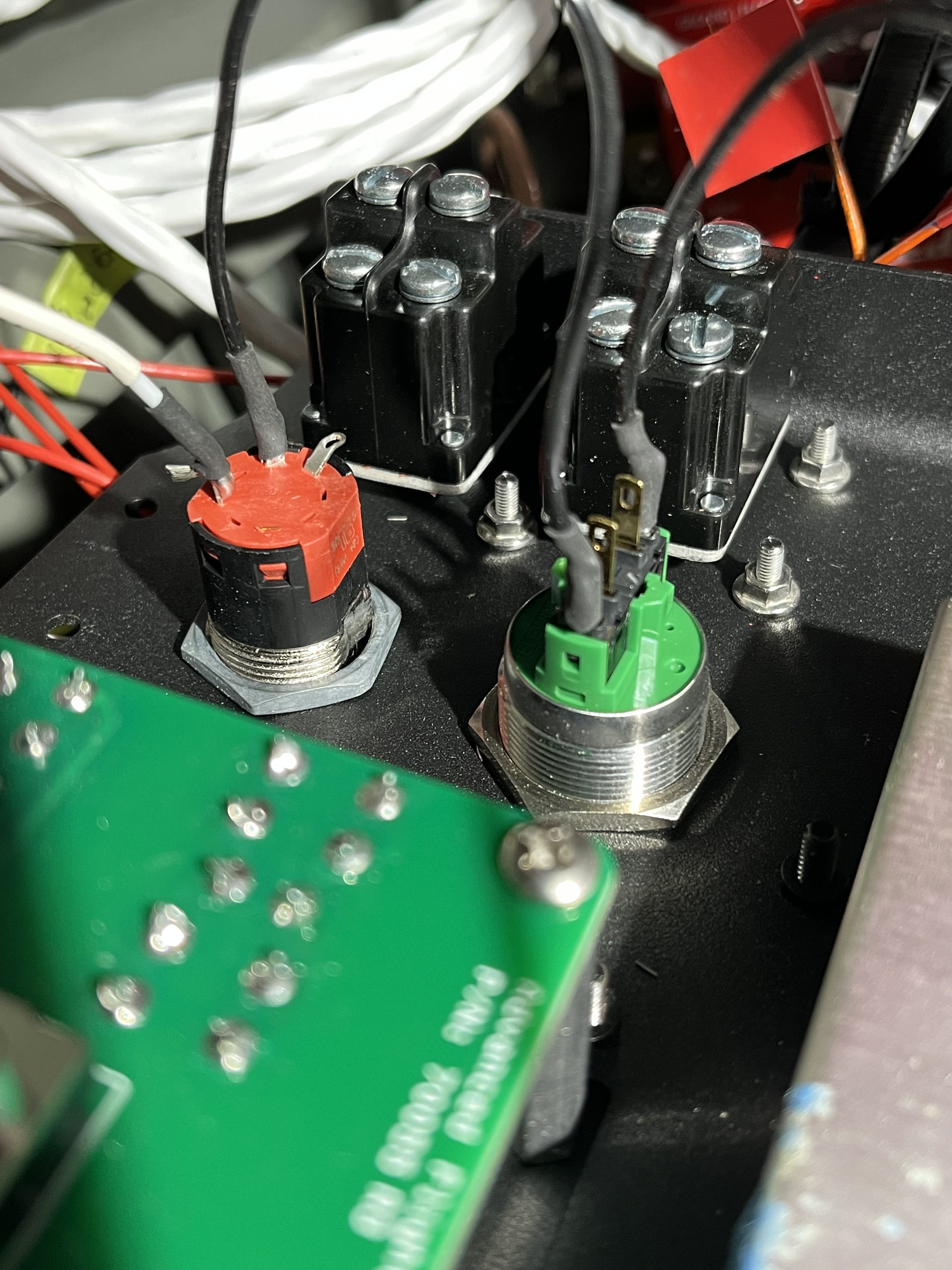

My solution after testing continuity with a multi-meter.
