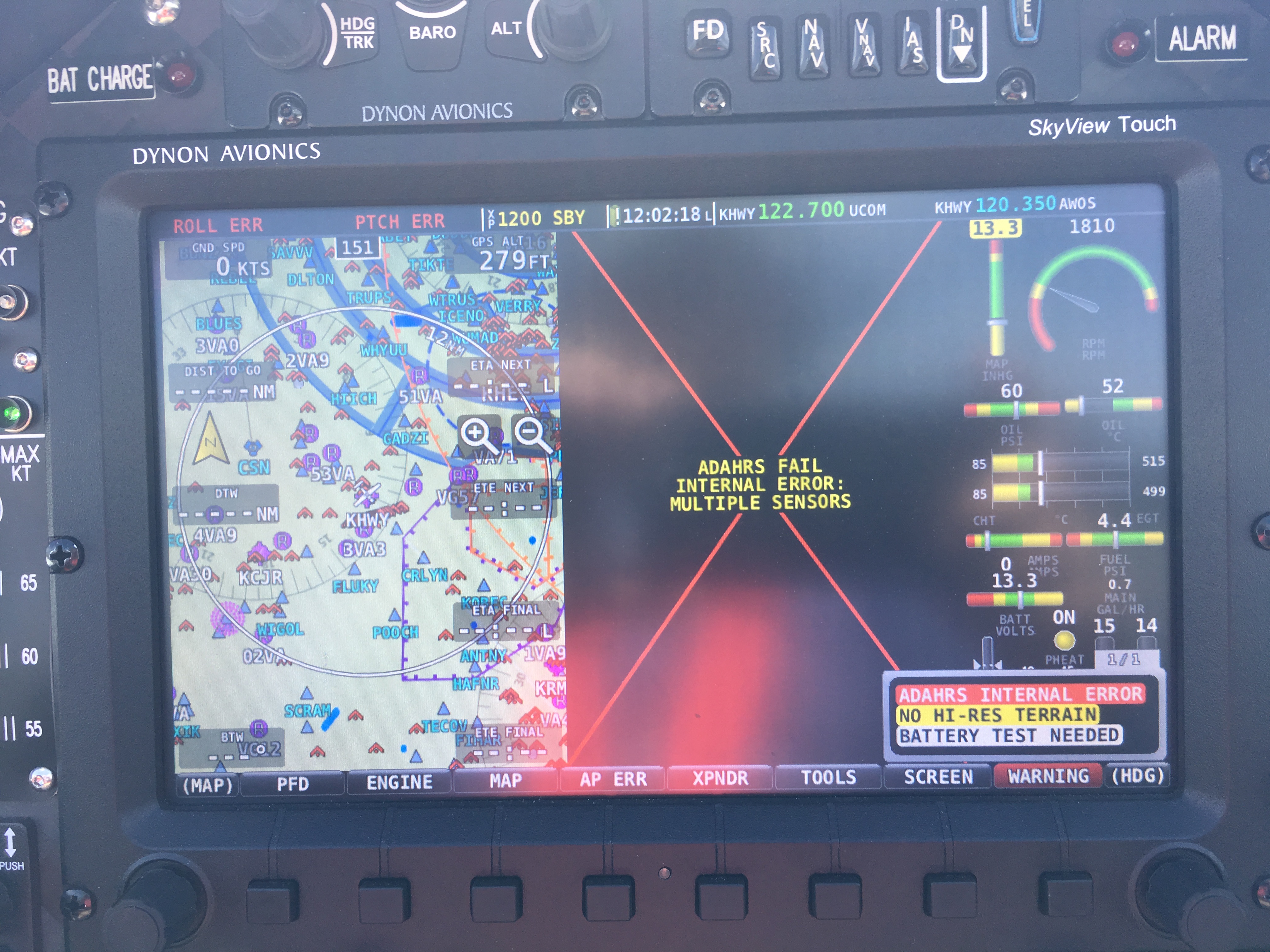

Got this error in the plane today.
I’ll upload troubleshooting logs shortly.
It alerted about 10 seconds after what otherwise looked like a normal boot up.
I shut down and restarted multiple times.
With same results.
Any ideas?
Thank you. :)

I notice that almost no one bothers to scale their photos before posting to the Forum.  It would sure help in troubleshooting!
I think we're going to need to see your ADAHRS here. Give our support team a call at 425-402-0433 or support at dynonavionics dot com for further help with this.

I had the same error after turning avionics master OFF during the boot phase. Didn't think that would cause a problem, but it seems that is the case - or a coincidence.
Is there anything that can be done in the field with a firmware flash, or is this a return to Dynon only repair?

I was able to make a field repair.... a mud dauber wasp was was nesting in the AOA port!   All is good.  :)
