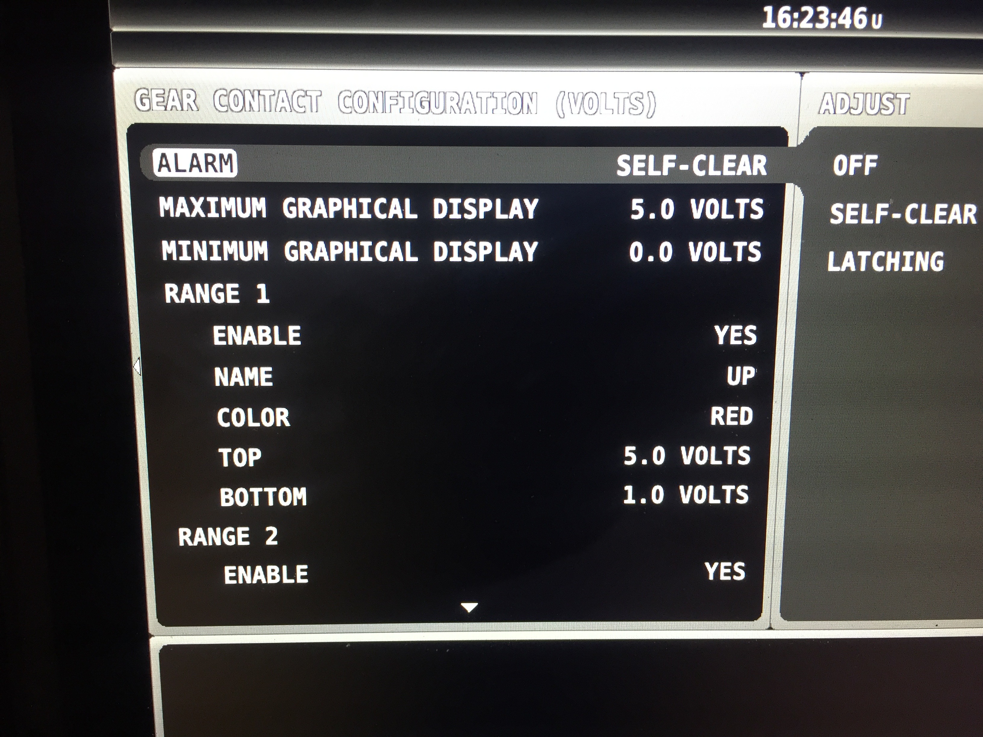

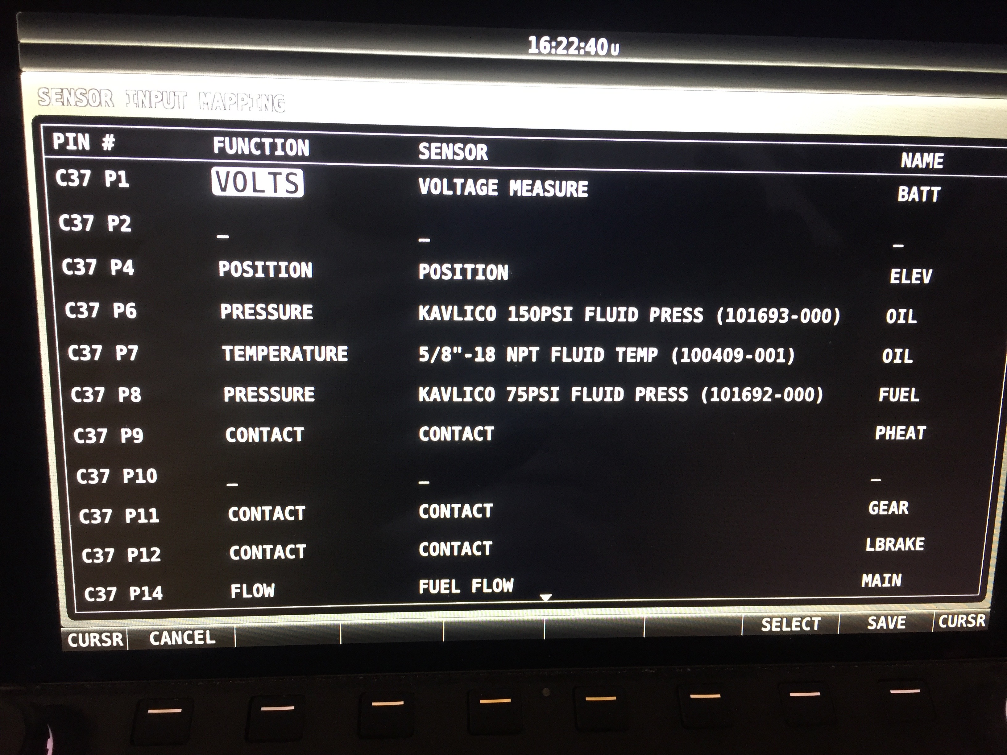

So the system can be configured either way. IE, higher or lower voltage can be UP or DOWN. Electrically, if the circuit is open you should see 5V on the pin, and 0V when grounded.
Put another way: First, set up the pin in the Sensor input mapping setup page under setup. Then, back up a step, go to sensor setup, and then you change two of the range/state names to UP and DOWN, and choose your voltages (and visual colors and other settings) for each.

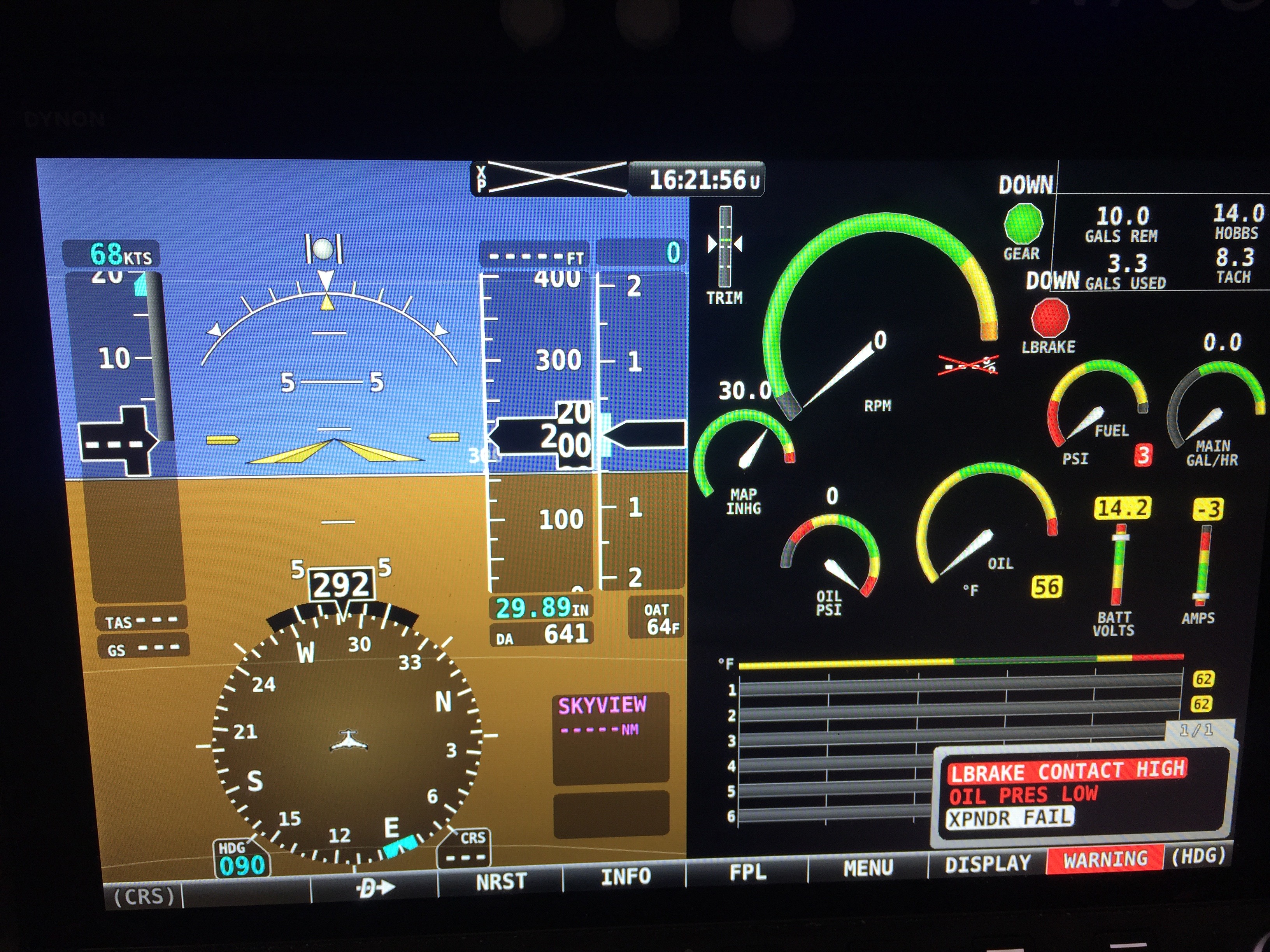

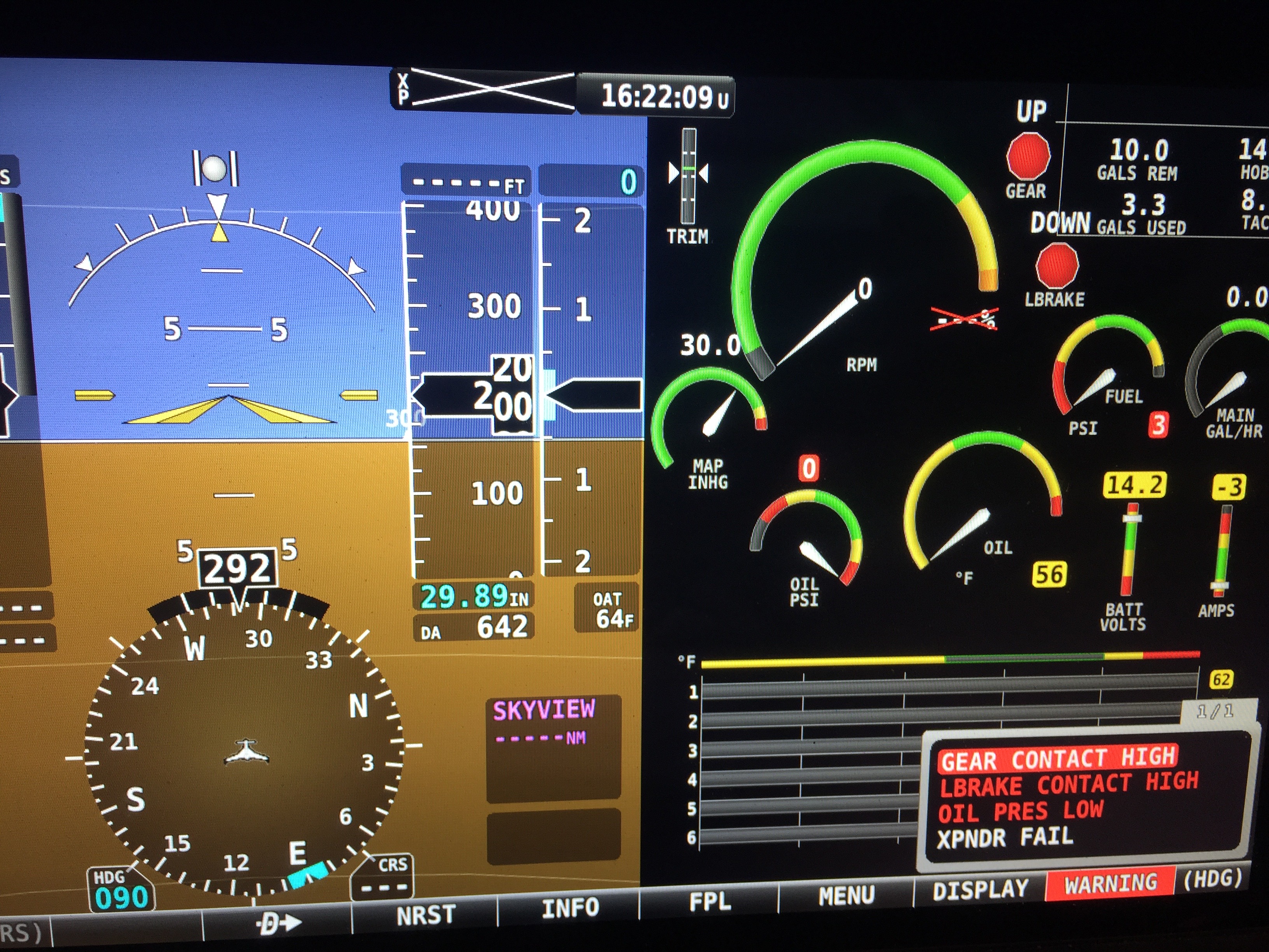

I really appreciate the help on this. I'm getting closer but not quite there yet. I've attached images of the engine panel and setup screens to reduce likelihood of confusion of what I actually have configured. At this point, in ground testing (0 KIAS) I'm getting an "Engine Monitor" instead of "Check Gear" audible warning when I raise the gear.
The Engine 50% display images just show that the HDX is recognizing that the Gear is UP and Down appropriately with the Red and green button light on the top right. You can see in the attached Engine Display screen that the text warning is "Gear Contact High".

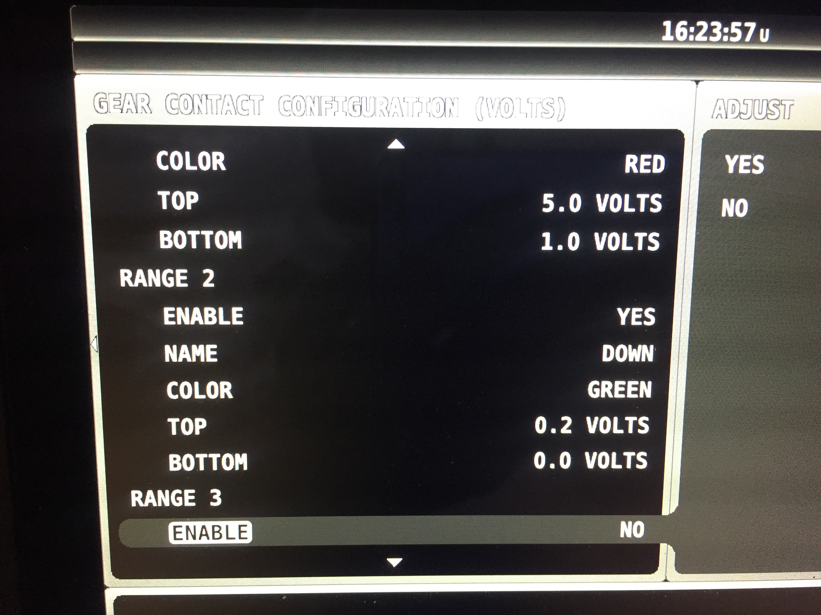

The Setup screens show the EMS P11 is assigned as a CONTACT and labeled GEAR, and that the Voltage Ranges are set to correspond to UP>1V and Down <0.2 V, which seems to work fine (let me know if i should be using different transition voltages).

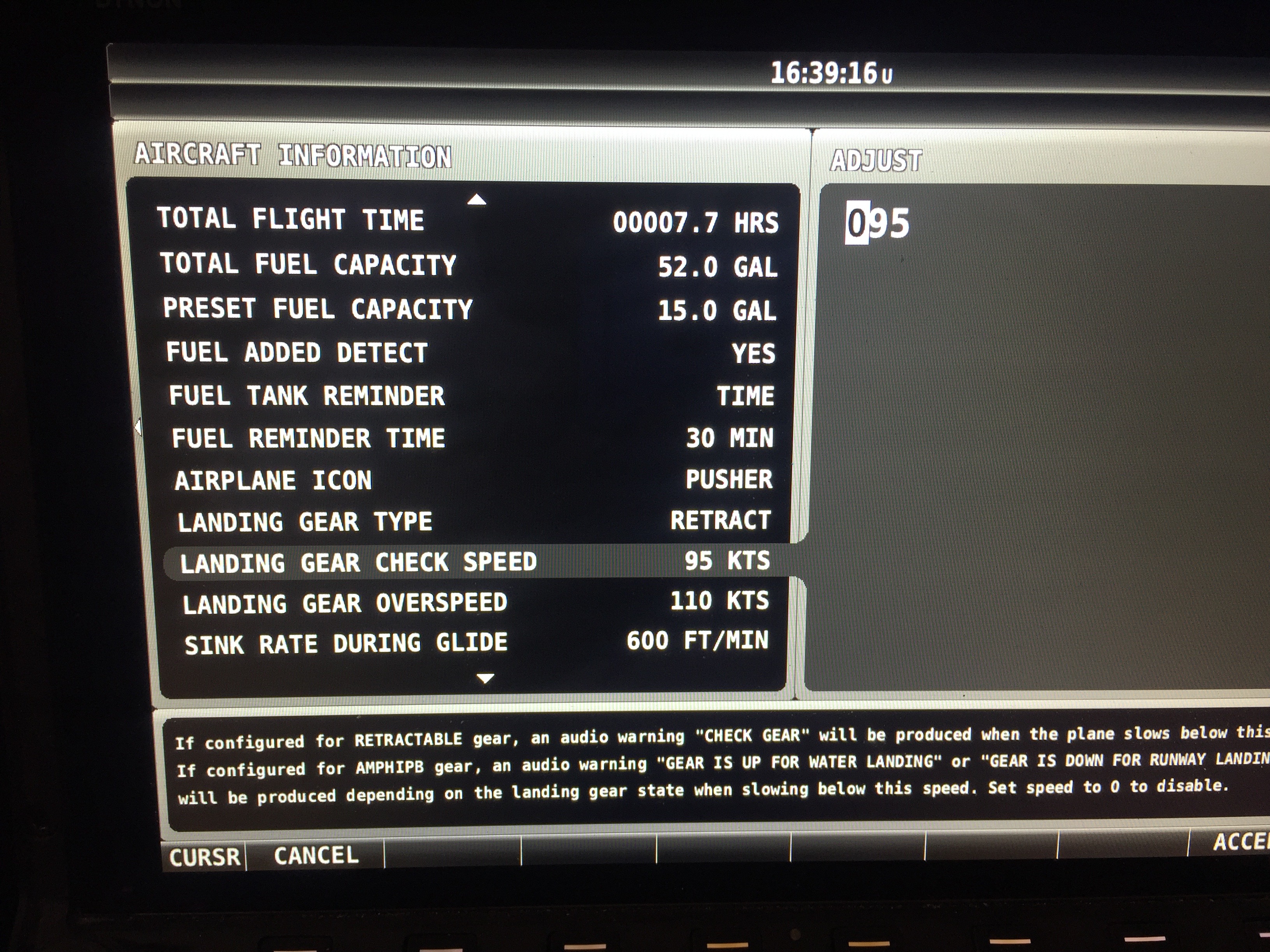

The last setup screen shows the Aircraft Information Page with the Check Gear speed set to 95kts and Gear Overspeed set to 110kts (the gear can take higher speeds, but I want the reminder early to pull the gear up).

The system works with the settings shown last. It gives an "Engine Monitor" audible when I raise the gear before reaching the Check Gear Speed, and it gives "Check Gear" when the gear is not lowered all the way and I pass DOWN through the check gear speed.
