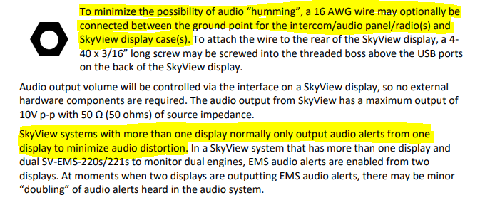

Hi!
I just finished adding a second HDX screen to my system. Back when I put together the harnesses I connected the audio outputs from both screens together and then into the Dynon Intercom/Audio Panel. I flew the airplane with only one screen for a couple of years with no issues, but now that I added the second screen I can hear a faint noise (some type of tac, tac, tac). If I turn off one of the screens off the noise goes away. I'm not sure where to look and I was wondering if anyone else has had the same type of issue in the past. I did not find anything searching the forums.
Thanks!
Aitor

Thank you for your response!
I'm confused by the second highlighted part. The paragraph right above those notes says:
If there is more than one display on a SkyView network, you MUST connect all displays’ audio
outputs to the same audio panel input to ensure that audio is always heard. Electrically short
the respective left and right outputs together for stereo mode (i.e., left-to-left and right-to-
right) or connect all audio outputs together for mono mode. The same rule applies for audio
grounds
Does it mean that I still connect both screens together, correct? Just ground the screens themselves to the same ground point as the COM and Audio Panel. The audio will only come from one screen even though both are shorted together (my understanding is the it comes from the screen that powers on first)
Thanks agai
Aitor
1,758
The connection between the displays GKC was referring to is chassis ground, not audio. Connecting the audio together from two screens without dual EMS modules can theoretically cause distortion, but normally doesn't, because, as you said, the first powered screen should be the only one to output audio. It's easy to test if that's a problem by temporarily disconnecting the audio from the secondary display. However, that problem doesn't occur unless both screens output the same audio at the same time. Your description indicates the problem is there all the time, so it's unlikely the screens are causing distortion by outputting audio at the same time. Try the ground wire suggestion GKC noted first.

Ok, that is what I thought. Thank you! I’ll ground the screens and see how it goes.
