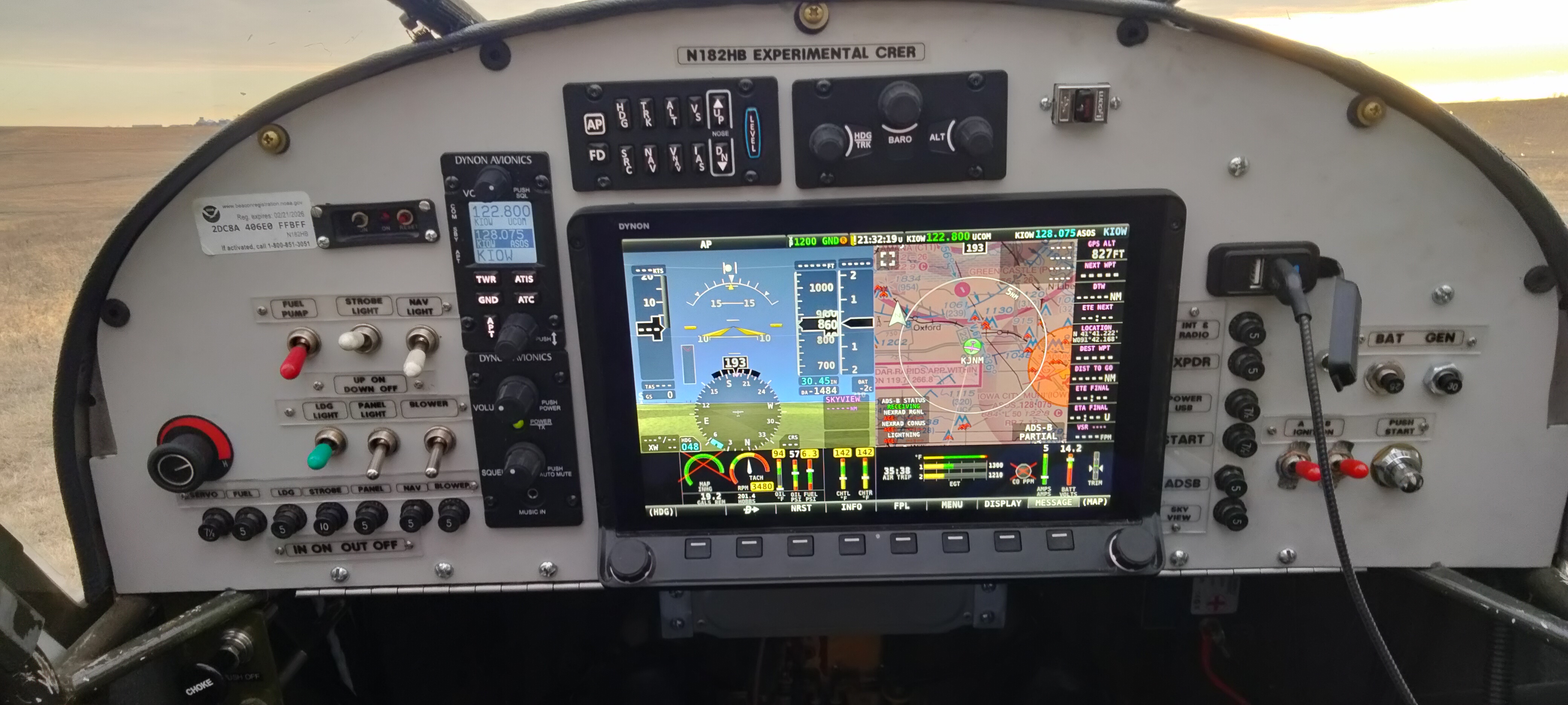

I have a small, tandem two-seat airplane with a very small panel including one radio panel and one intercom panel. I want to add a second radio panel and think I'll have to use the intercom panel space for it. That means I need to find a place for an audio control panel or function including intercom.

I'd prefer a Dynon radio and can put the radio panel in the space currently occupied by the intercom panel. I'm looking for an audio panel function to handle the second radio and an intercom function, preferably just using toggle switches. If I put in the Trig I'd still need an audio panel so it doesn't address my question. The PSE PMA4000 is interesting but won't fit in the dash panel, which folds down, because it is way to long (deep).

I think I'd have the intercom in horizontal format where the USB dongle is and put your 2nd radio where the intercom currently sits.

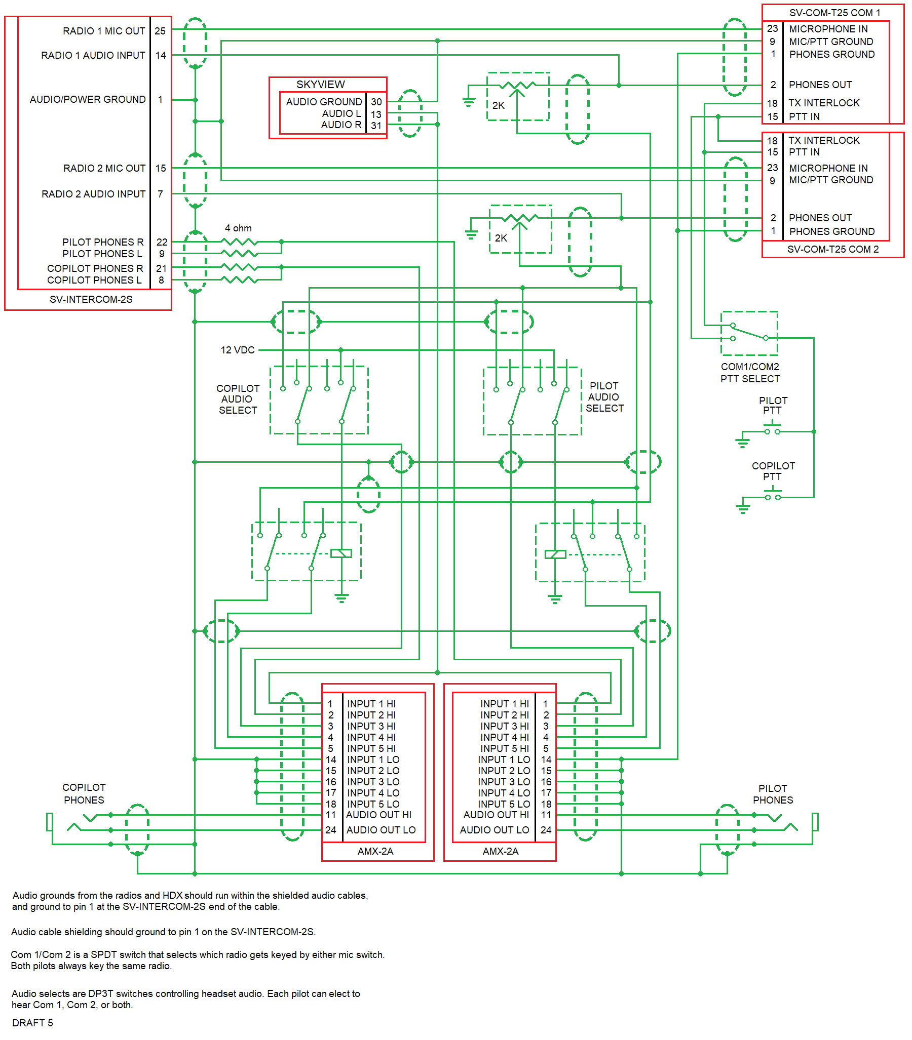

You can use a simple toggle switch for com select, and use knobs for volume and squelch, all of which you can locate wherever you want. Then use a mixer to combine your audio as Jake suggested. That's most of the function the intercom panel performs. It's little more than a few switches and knobs. This is a somewhat similar example where someone wanted to get rid of their audio panel:
That just illustrates the concept. It still has the intercom, but that could actually be replaced easier than a comm panel. It just depends on how much time and effort you want to devote to it, and how many features you want to preserve.

Here is an application drawing for the AMX-2A. MakePlane also sells the AMX-10A that has both mono and stereo inputs. FMI
https://www.huvver.tech/open-source-hardware/
https://www.huvver.tech/wp-content/uploads/AMX-10A_install_A4.pdf
I am the designer of these products. They take no panel space and can be mounted almost anywhere. Contact MakerPlane to purchase.
Note: The PS Engineering intercom is very similar to the Dynon intercom… not an accident…

Keeping the intercom is probably best, if you have the room. I'm curious where you would put the SPST switches or knobs. If you switch or attenuate either radio audio into the intercom, both pilots are affected equally. Audio from both radios comes out of the intercom mixed together, so there's no way to turn off or attenuate the audio from an individual radio at that point. That's why the diagram above uses the DP3Ts, relays and mixers.

I'm sorry. I meant where would you put them electrically, not physically. The PTT is easy to switch. Even easier still if you don't want to allow transmit from the rear cockpit.
The RX audio is a different matter. For instance, a switch for the audio from COM 1 to the intercom would enable or kill COM 1 audio to both cockpits. The same for COM 2. There would be no independent control. That's a simple thing if you want both cockpits to hear the same thing. You wouldn't even need two switches for that. A single switch could select audio from either or both radios. But you can't select or control volume on one radio for one cockpit, and the other radio for the other cockpit, unless you have a mixer. Without a mixer, it's all or nothing.
These concepts have been discussed in numerous threads here. I'll include some that may be helpful.
1,842
Switching and impedance were also discussed here:
