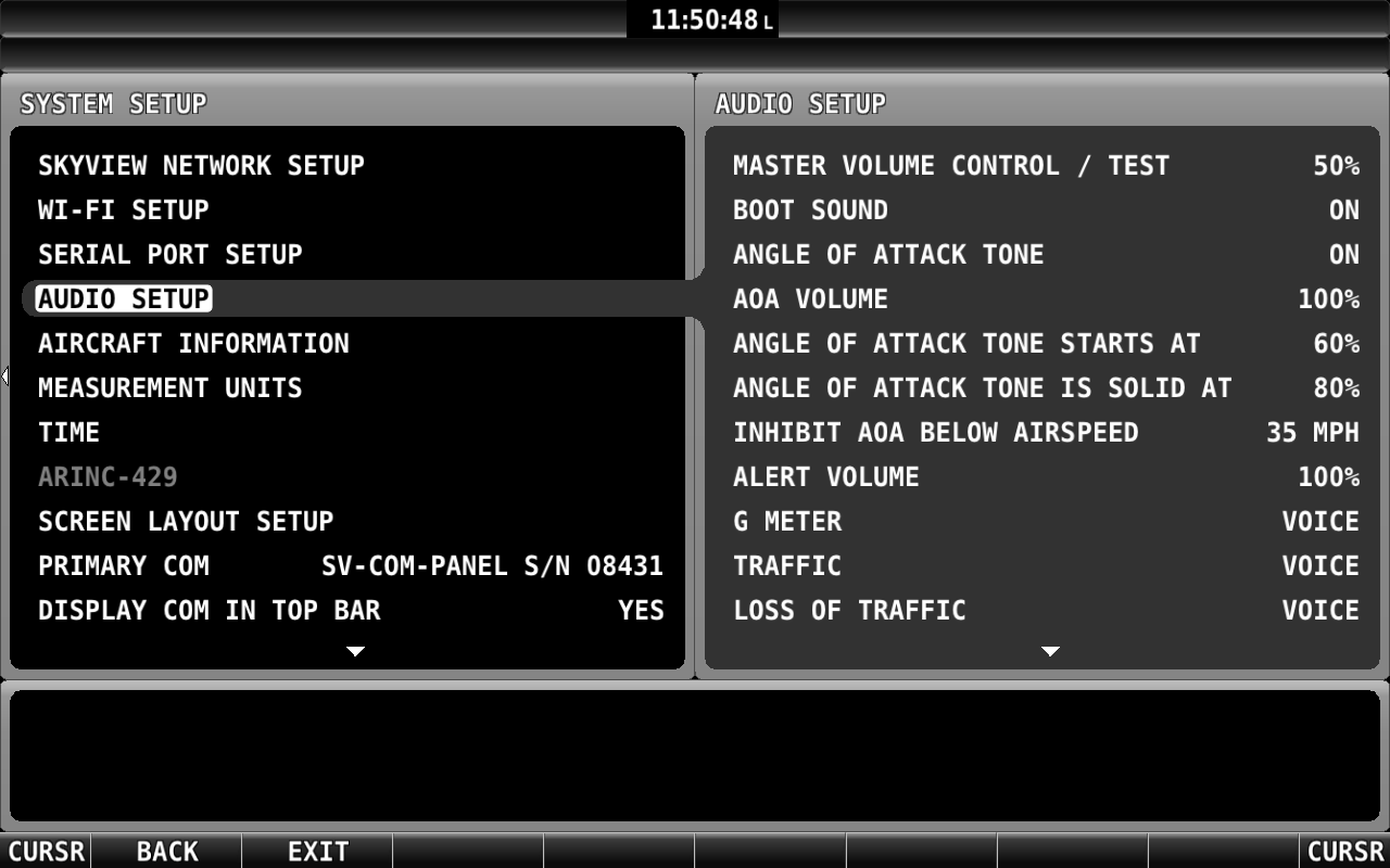

A screenshot of the Setup menu Rhino said.
