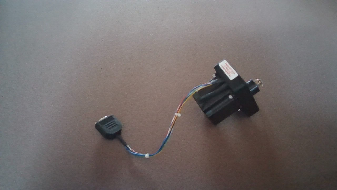

Wires on the servo end seem well anchored. Are you suggesting that a loose fitting wire could do this? I have had my suspicions because the DB9 fitting on the wire which leads to the glass panel seems lightweight and is missing a few unneeded pins . I know that serial connections do not require all the of the 9 pins necessarily. I do not know if Dynon sends these to the installer pre-wired with connectors or if the installer has to pin out the connectors manually. I have had my suspicions of the connector on the panel side of things for a while. Sometimes the AP would just disconnect without warning. Then it would magically reappear with the next flight. I have a feeling the pin out was done by the installer. I know that when Dynon sent me a new updated transponder, they included a manual pin out kit which I didn't use. I may look in the Dynon installation manual for the pin out diagram. Thanks.
