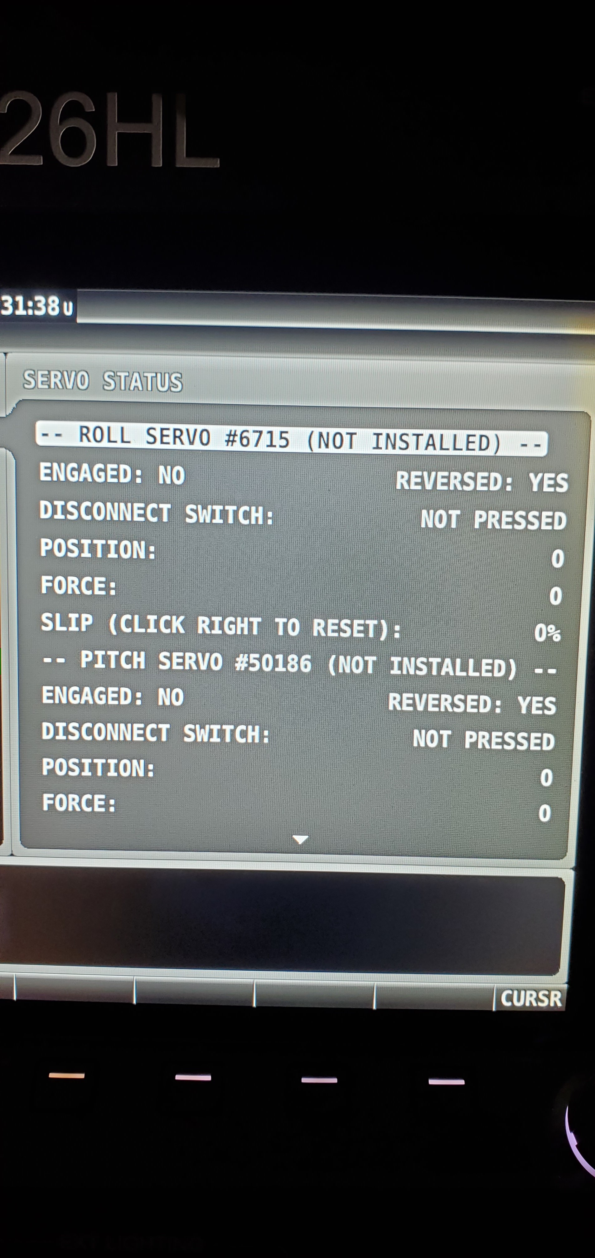

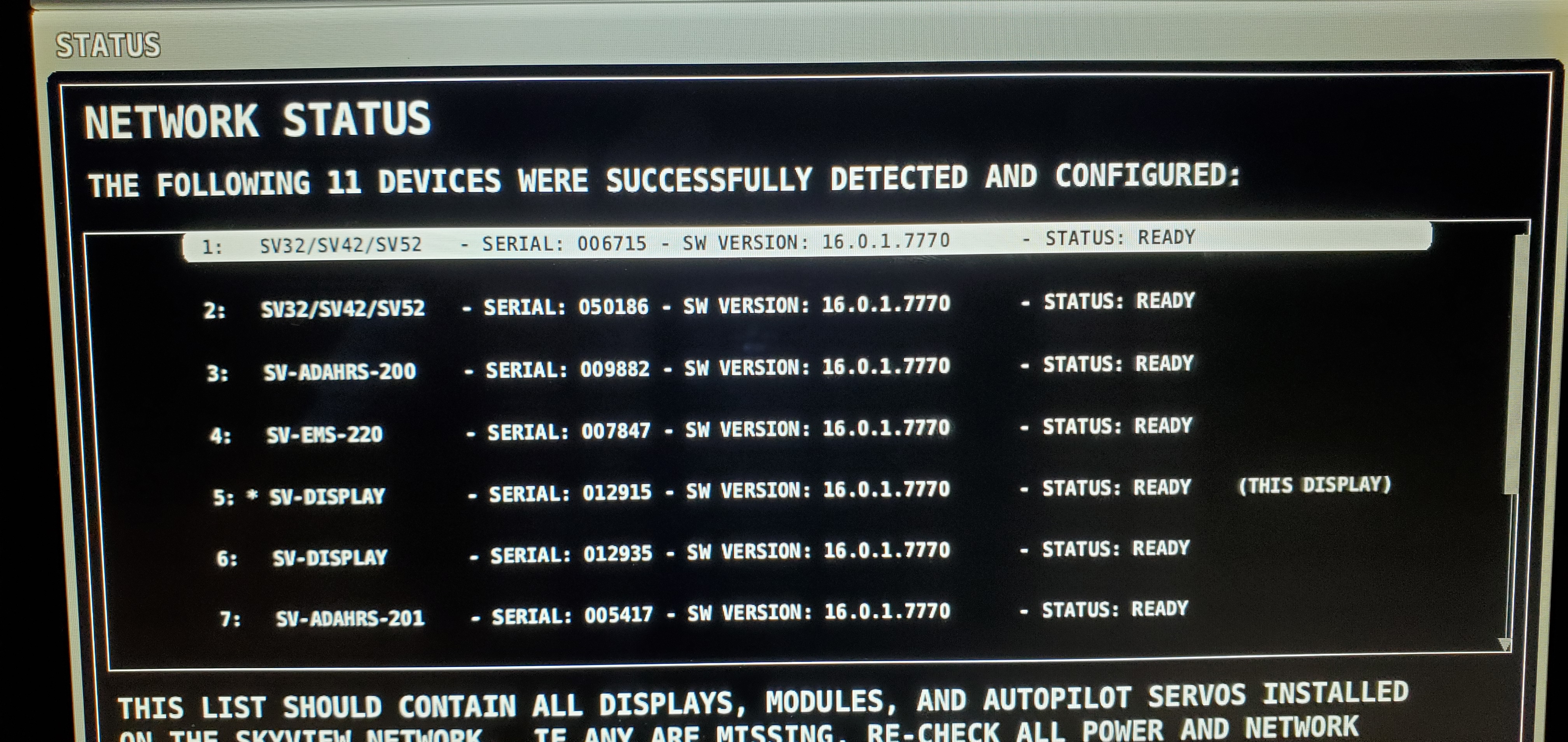

Well after running through the zero pressure calibration, everything started working fine, but yesterday the pitch servo wouldn't engage. I went into Autopilot configuration this morning and walked through moving full pitch right left etc... then it asked for the yaw servo configuration, well I don't have a yaw servo so I couldn't figure out how to get past that point and just clicked the ok button twice. Well now I don't show any servos installed when I go into the configuration, but I can see them in the Network Status screen set to ready. At that point I walked away to try and regroup and figure out what my next steps should be.
