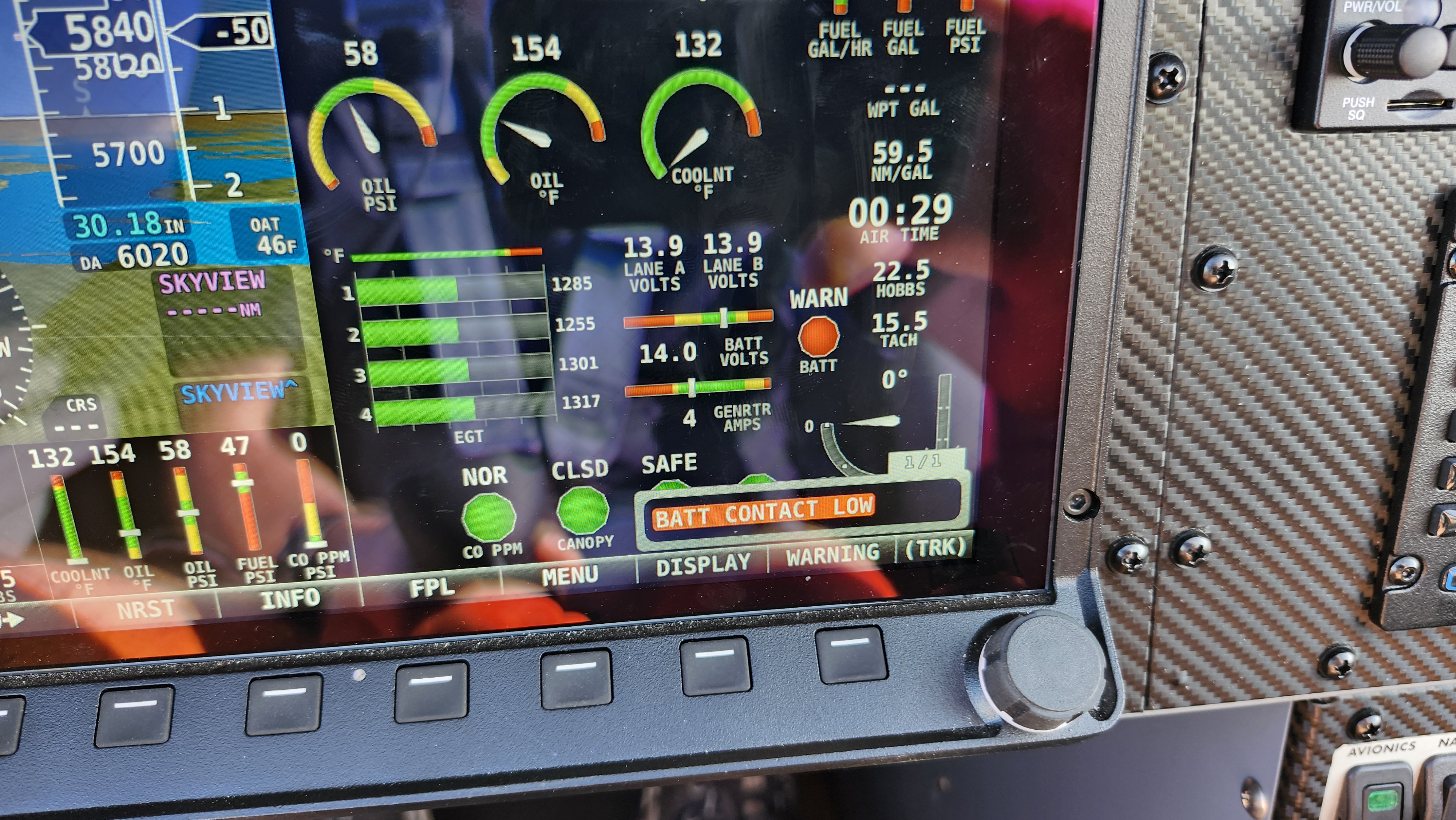

Yesterday while flying my RV-12iS my Skyview (v16.7) issued a WARNING with the text BATT CONTACT LOW about 30 minutes into the flight. The error continued for about 10 minutes, then cleared on it's own. I've searched the Dynon manuals, Dynon forums, and VAF forums, and I can find no references to this error. It's not clear to me whether it refers to a problem with the main battery or the Dynon backup battery, or what it means by "contact low". I checked the battery voltages and both are fully charged. Does anybody know what this error means and what might have caused it?

Your BATT warning light is on, suggesting low battery voltage. Do you have a contact pin on the EMS configured as a battery warning? Do you have a VP-X?

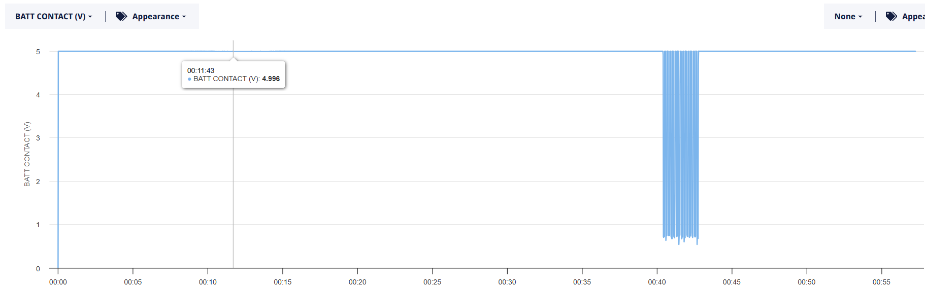

Here's some more data to help understand this issue. I downloaded the Skyview data logs and plotted them on Savvy, and sure enough the sensor input for BATT CONTACT shows major voltage fluctuations at the 40 min mark, lasting about 2.5 minutes (it sure seemed longer than that in flight!). But the normal voltage for this sensor appears to be 5 V, so I don't know what battery this is referring to or see any references in the manual. Does anybody know? At this point in the flight I was doing some low speed maneuvering, so I wonder if that could have triggered this. This sensor went back to normal after I resumed normal cruise flight.

5 volts is the internal bias voltage on the EMS pin. That should always be there. You might also want to look at the explanation here:
jetset44
Dec 9, 2024
8
Aha, that link was very helpful. That sensor reports any voltage above 5V (up to 15V) as 5V, so it does appear I have a loose connection somewhere in the battery circuit. I'll start by checking the connections there. Thanks, Bob!

Very helpful again, airguy! In the time history plot in post #3, you can see the low voltage flashed every 5 seconds exactly for 2.5 minutes--which confirms this is likely a fault alarm coming from the battery. And since this occurred in flight and lasted only a short time, the EarthX fault table suggests the cause was likely that the cells were temporarily unbalanced during a period of high current charging. That makes sense since this occurred after about 15-20 minutes of low speed flight practice (stalls and slow speed maneuvering, flaps up and down), when the engine RPM (and thus generator current) was low but current drain was high. The flashing went away shortly after I throttled up. Nevertheless, I'll keep a close watch to ensure this doesn't indicate a more serious issue with the battery. I hope not, since both the battery and airplane are brand new (20 hours Hobbs time).
That said, I am a little surprised the Skyview reported this as a battery contact issue rather than a battery fault indication. In a non-EFIS system, the battery fault indicator would be wired to an LED on the panel and simply flash if there was a problem with the battery. The battery voltage to the bus wouldn't change, only the light would illuminate. But if I understand the Dynon data log right, it appears the actual battery voltage to the bus flashed here. Is that normal or typical? Am I reading that right?

That isn't bus voltage. It's the indicator circuit from the battery BMS. The Skyview has no idea what's going on with your battery, because the BMS doesn't actually communicate with Skyview. What you're seeing is that same light going on and off. It's just doing that on the Skyview instead of on a dash light. It's intended only as a fault notification, not a diagnostic tool.
