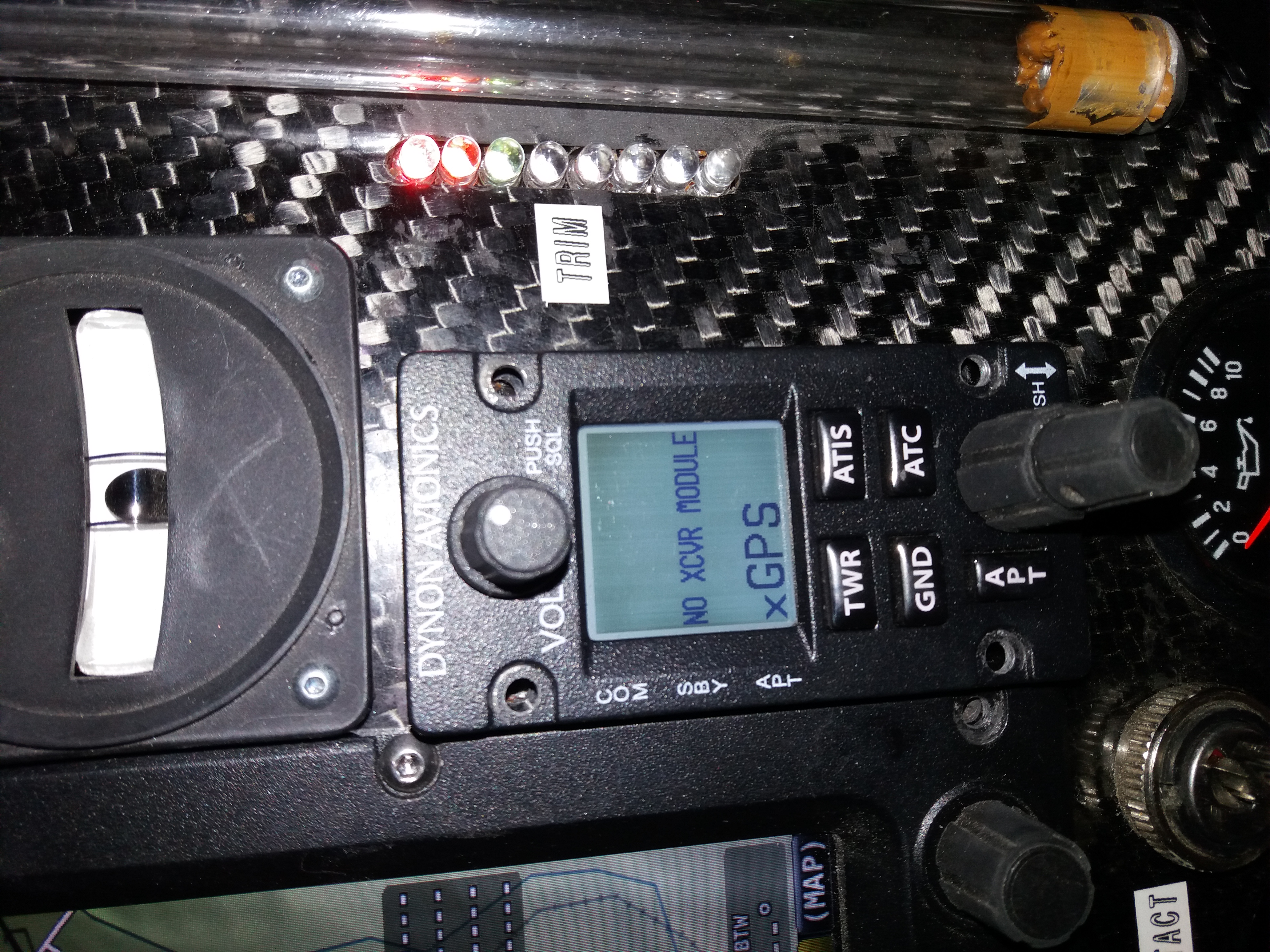

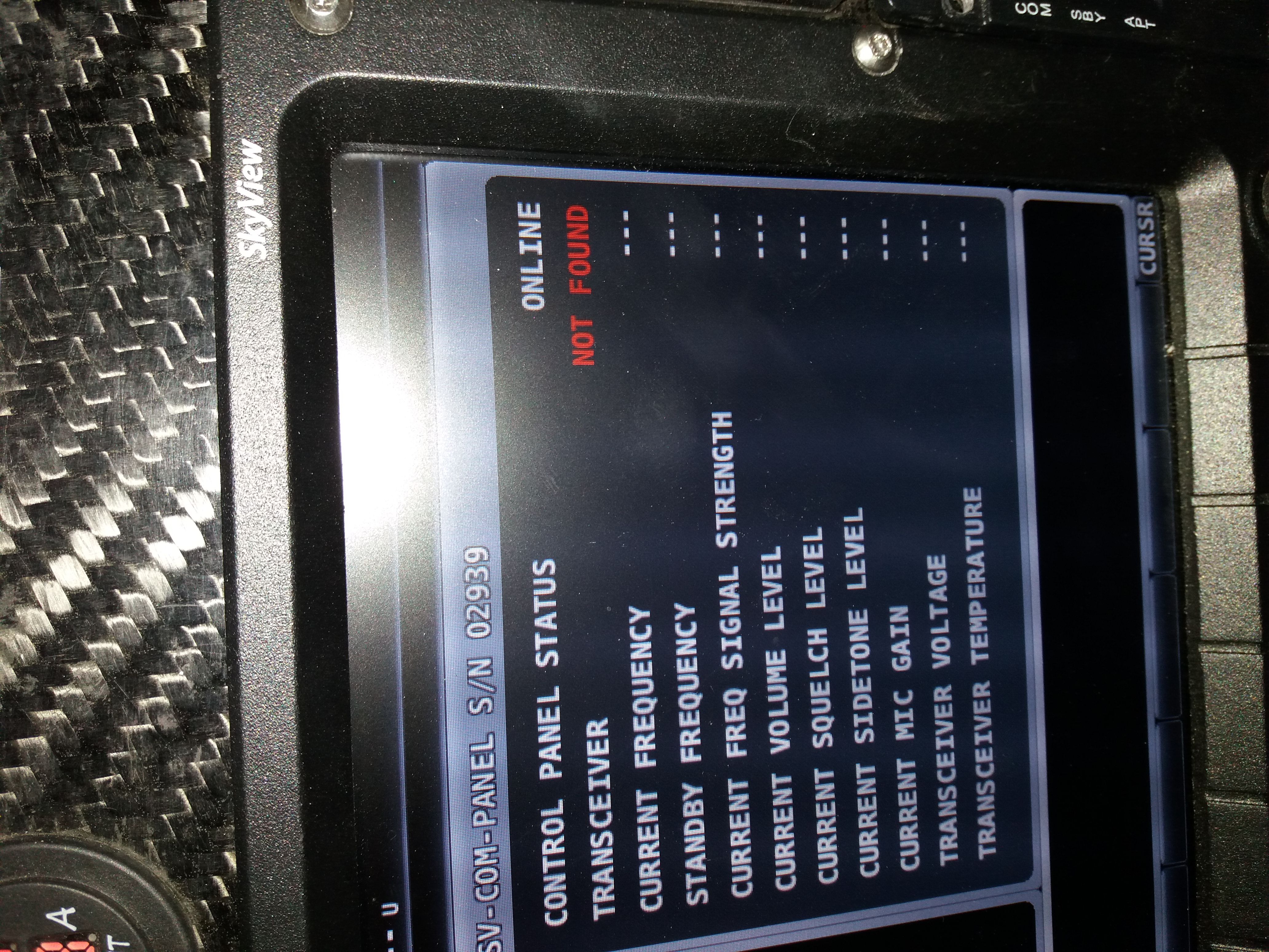

Bonjour J'ai problème de fonctionnement de ma radio SV com X83
En effet le Sv com panel ne reconnait pas la radio et pourtant le câblage est correct
peux t'on me donner la solution
Merci CDLT H Pasté

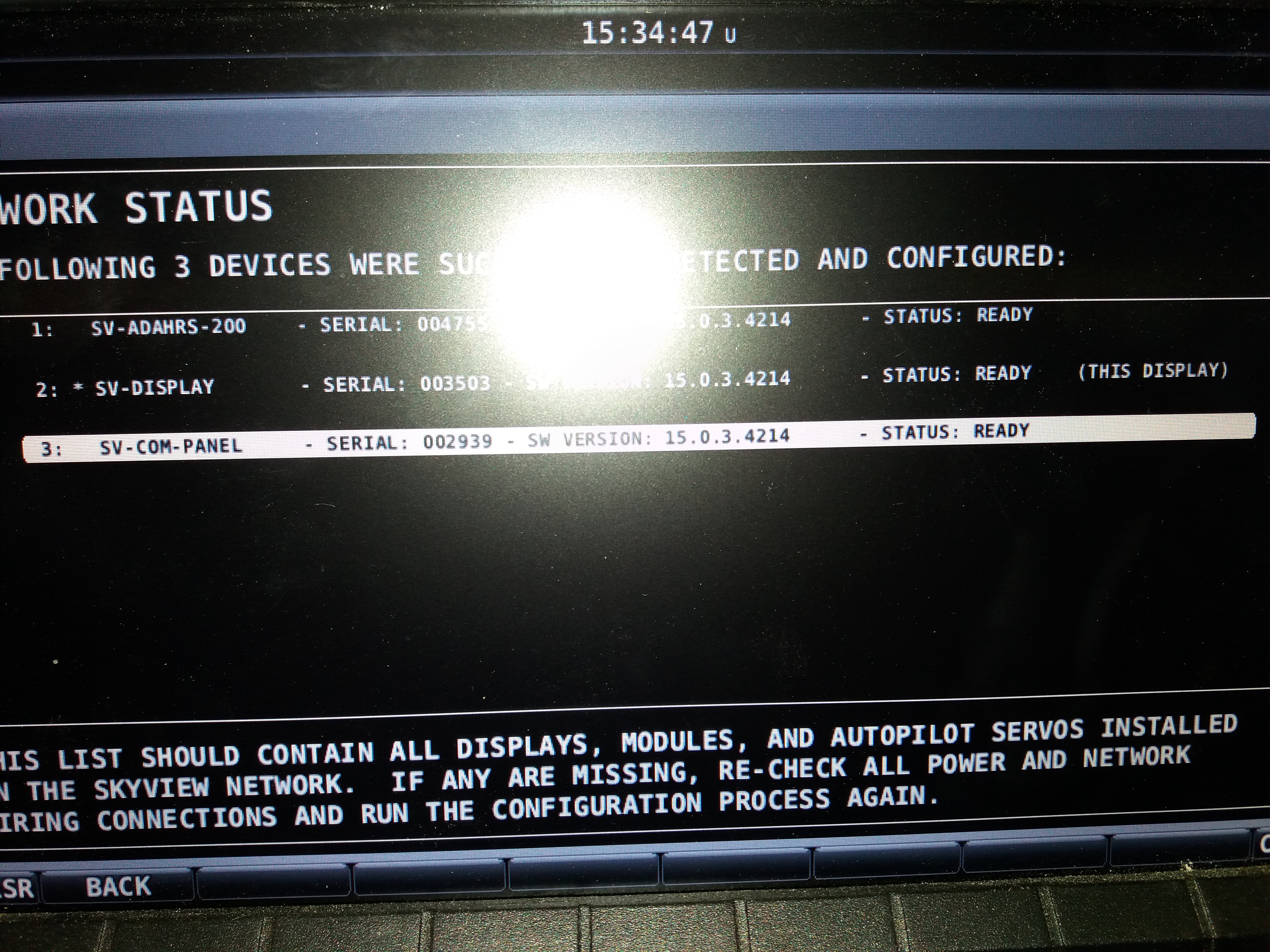

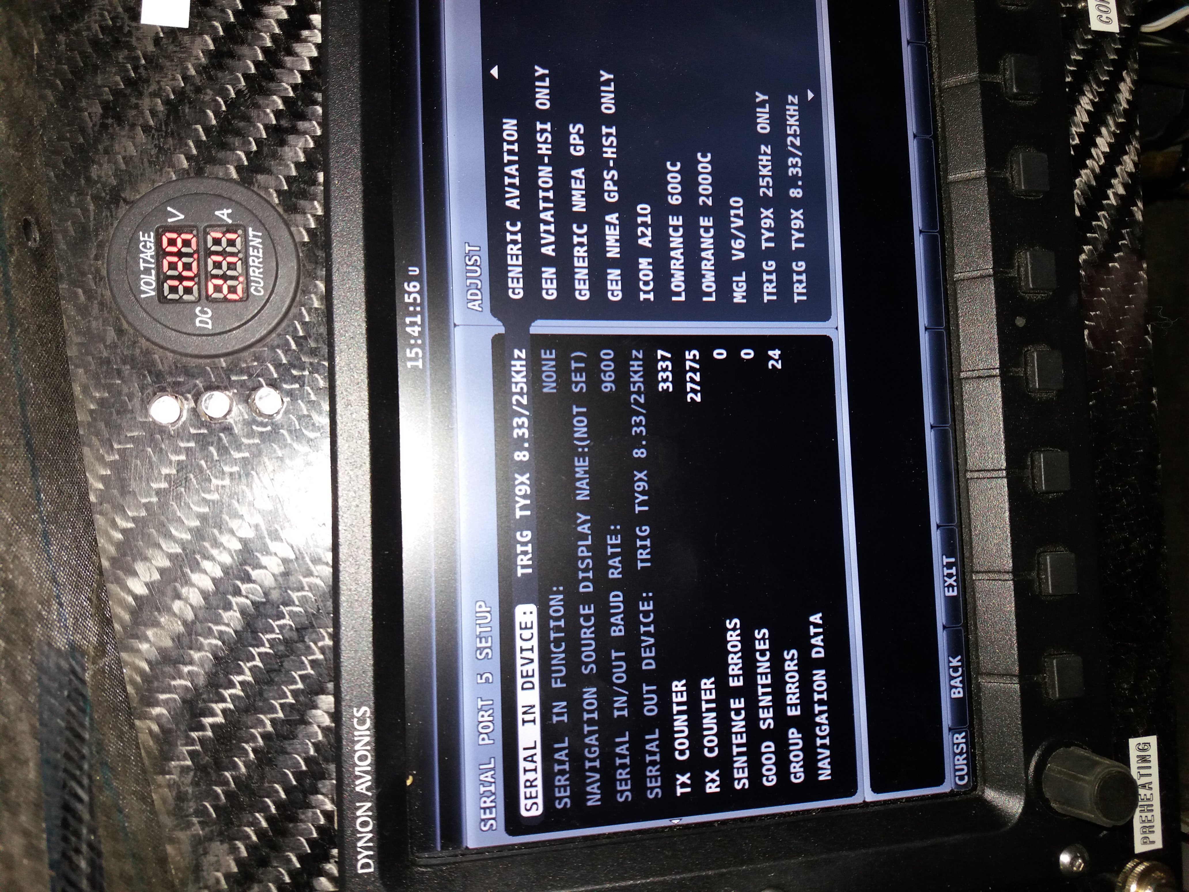

There should not be any radio configured on the serial port - the COM radio is configured via SkyView Network. If you're not seeing anything on the status page, either the connectivity or power to the transceiver module is not connected, or there is something wrong with the transceiver module itself. However, know that the X83 transceiver module is VERY reliable and I don't know of any that have failed when new. In addition to being connected to the SV-COM-PANEL, is the transceiver module being externally powered as is required?
