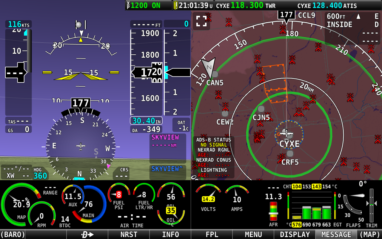

I'm running 16.2.4 and I think I may have found a bug in the EMS display. I am running a Rotax 912 iS and in my hand coded engine instrument displays, I use the arc widget, specifically WIDGET_INVERTED_ARC_VAL_CENTER to display fuel pressure (ems1_c37_p8) and oil temperature (ems1_CAN_OIL_WIDGET={).
In both cases the needle appears to be now showing zero on the left instead of the right. Have we lost the _INVERTED_ logic somewhere? I haven't yet checked with the engine running to see which way the needle is now rotating. With "inverted" specified, it should rotate counter clockwise as the quantity increases.

Confirmed today that the gauge pointer in "Inverted" mode widgets no longer runs anti clockwise. Is this deliberate or a bug?

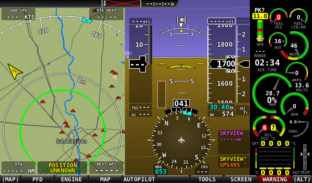

I found the same problem. My Main fuel gauge is an inverted arc, but it's reading clockwise. Is there a fix for this?
