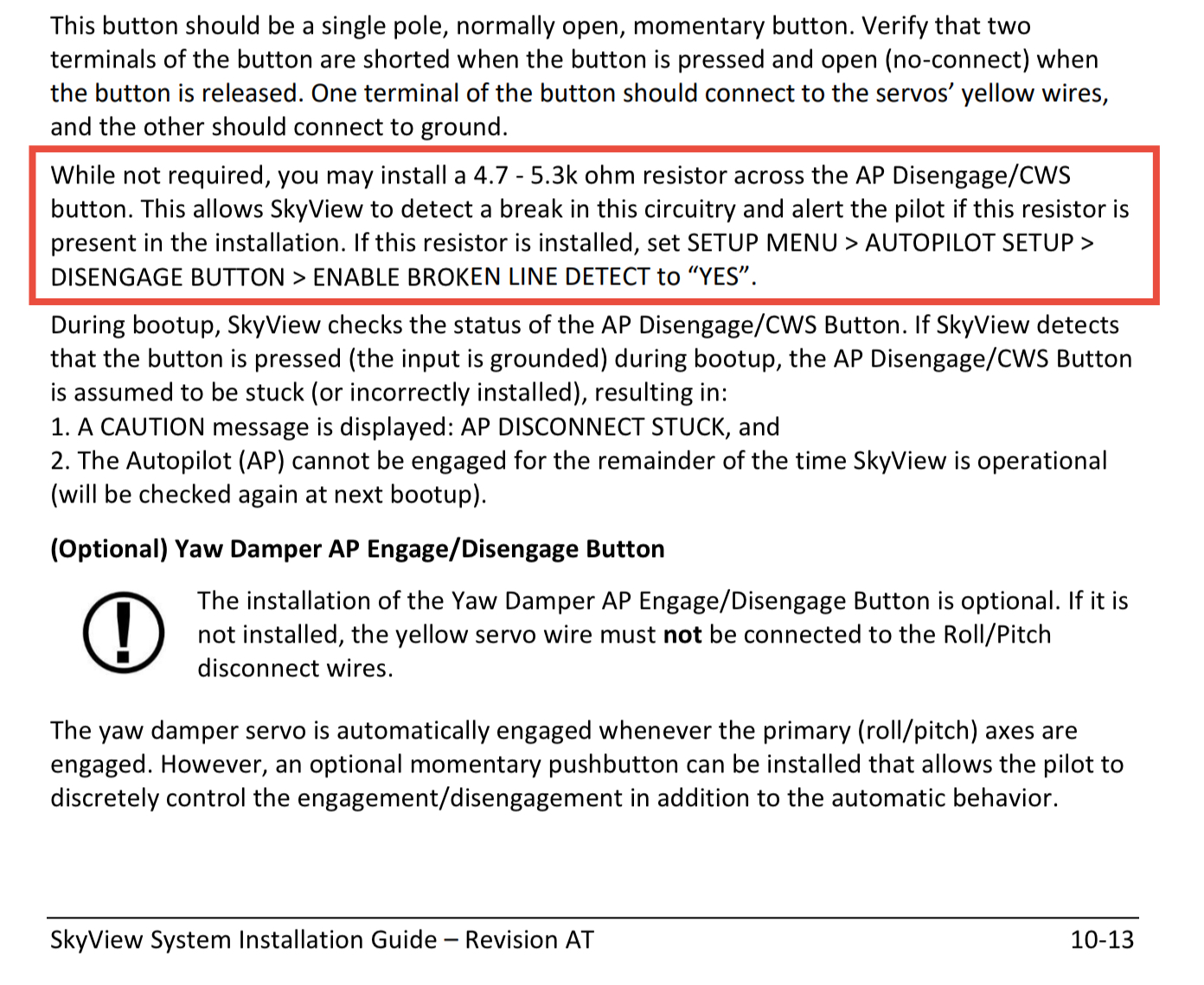

On the dual HDX system in my RV12, I occasionally get an aural Caution alert but there is no accompanying "explanation" when I push the message button - so I'm left to wonder what the Caution was for?
Bob Y
May 28, 2022
39
That was happening to me too. Dynon support pointed me to the setting that senses if the autopilot disconnect-switch wire is broken. I didn’t have the resistor connected across the switch and turning off that setting did the trick for me.

The AP disconnect switch is a normally-open contact. The resistor provides a low current flow to the AP module, which apparently is how it differentiates a completely open circuit due to a broken wire from a good circuit through the low current flow; at least that’s how I believe it works. So, if you don’t have the resistor across the AP disconnect contact, the AP module interprets no current flow to mean a broken connection. I’d still suggest checking to see how you’re configured and turn this off if it’s on. I’m just sharing the culprit that solved my CAUTION messages.
