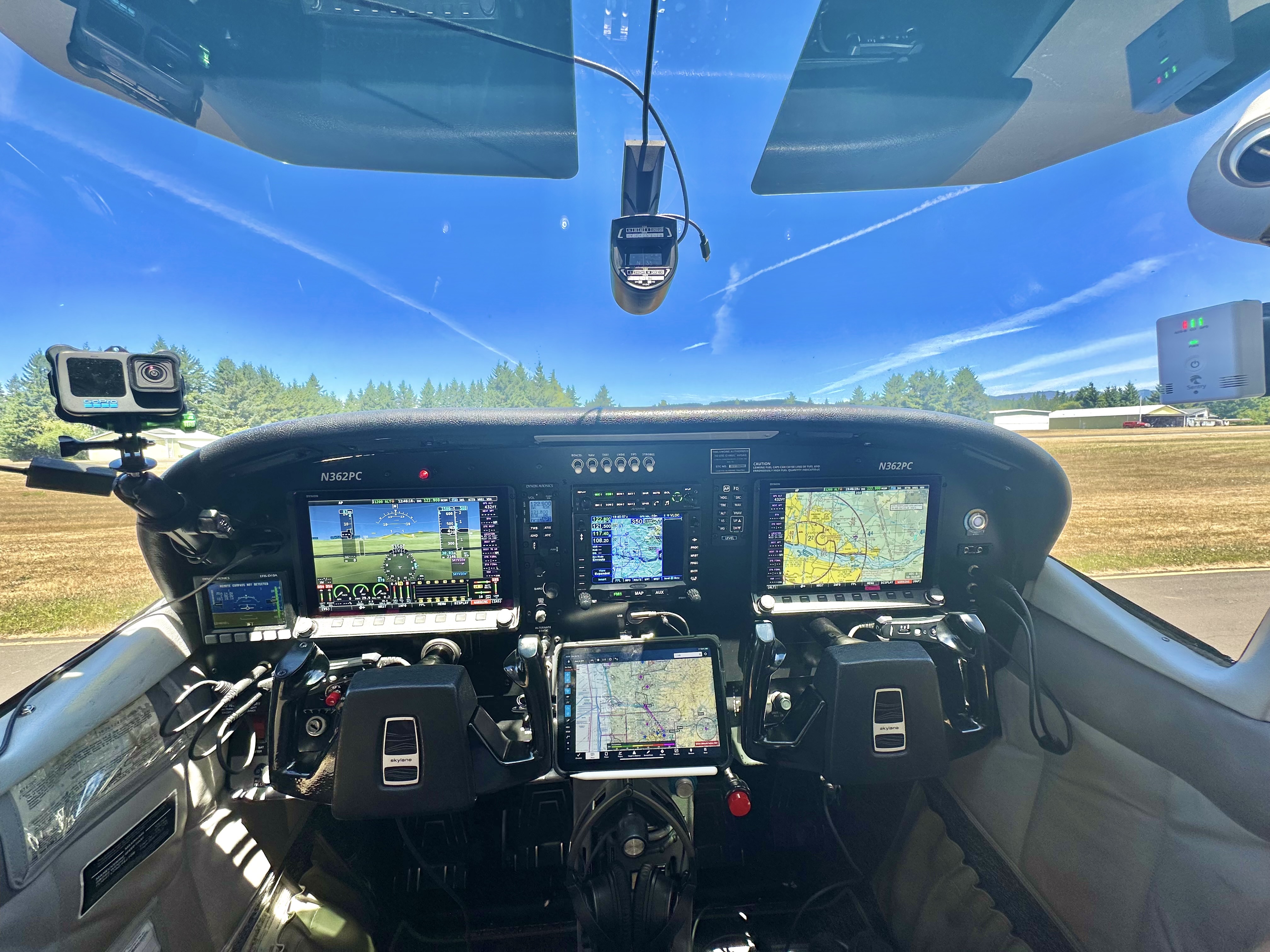

Finished this up about 6 weeks ago... still debugging a bunch of things but very happy with all the decisions that went into this.

How did you mount this, specifically? I've got a monolithic panel similar to this that I'm having difficulty mounting on a TR182. The panel provided to us has the displays centered over the yokes, which puts the co-pilot's display in the curve where Cessna had the panel canted over to give the pilot a better view of the 4in1 gauge. That bend means the pilot's and co-pilot's side don't occupy the same planar space.
You can't bring the pilot's side aft because it has to be the mounting surface for the yoke assembly, and you can't move the co-pilot's forward for similar reasons.
Then there's the whole, weird, 60 degree bend in the circuit breaker panel they made to stiffen the whole arrangement, making a monolithic panel seem like a non-starter, but here it is, and it looks pretty good. Seriously - what was your method there? :D

Installer and I designed/created a spacer between the OEM pilot side panel and the new single flat panel all the way across. There is about a 1 inch gap behind the pilot side of the new panel to the old frame/structure. Radio stack was also moved forward with a custom bracket that allows for adjustable depth of the audio panel and nav/com. This avoids two or more pieces and keeps everything at the same depth. The original yoke supports remain exactly where they were and the new panel has a floating hole that allows pilot side yoke to move freely through new panel. The glare shield was also modified to remove the portion that stepped towards the prop on the pilot side and is now trimmed to match depth of co-pilot side. The entire panel is thick enough that it is structurally supporting the avionics tray behind the PFD... the MFD has a void behind it other than Dynon networking cables.

Hey, thanks for this. It's strangely familiar. Unfortunately, all the key points I'm really curious about aren't actually present or easy to figure out from the video.
Your panel has better/wider spacing of the display units which allows a bit more flexibility in the mounting and avoids having the co-pilot's display "in the bend" but it's irrelevant because you just spaced it out to keep it flat all the way across, anyway, which might still be on the table for us. I'll have to do some investigation.

correct the right seat display and autopilot panel "span" the bend as there is no angles to compensate for when moving from side to side. The structure behind the far right side of the panel is un-modified, as you move to the pilot side spacers were installed to keep everything flat.
Yeah, I gathered that just from your earlier description. I had just been hoping to see some closer detail of it, but it looks like I've arrived at a similar solution. :D
