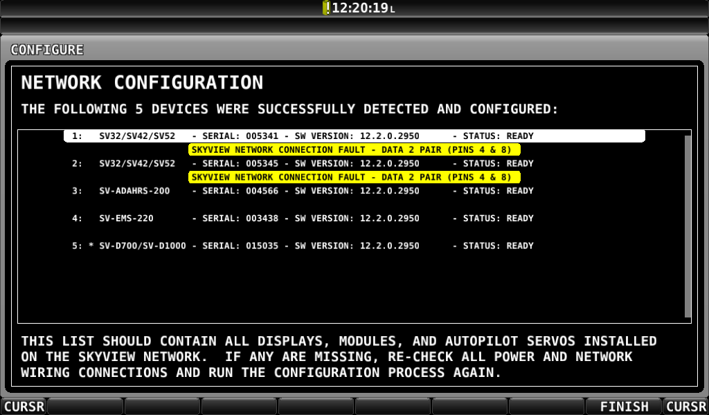

I am re-installing my freshly converted to touch skyview, and this pops up!  Nothing has been rewired or changed, but I previously had some issues with calibrating my autopilot servos.
I am not even sure just what this screenshot wants me to do.  Help!

Don,
Your SkyView screen cannot talk to your two servos on one of the redundant data pairs. It means either wire 4 or 6 8 is broken between the screen and where it goes to the servos.
Could just be a loose connector somewhere. Your servos will work, but we're warning you that you have lost redundancy.
