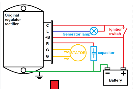

Looks like L drops a ground when the alternator stops output. C is powered when the alternator switch is on.

Looks to be the Rotax 965-349, made by Ducati. Bob Nuckolls has a diagram at Aeroelectric. The numbers vary slightly, but the diagram looks to functionally match another diagram with the correct part numbers. The resolution on that diagram stinks though, so I used Bob's here.
Looks to me like the lamp does operate off a difference of potential from the battery and generator, but someone can correct me if I'm wrong on that.

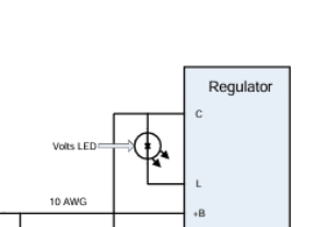

Works perfectly on my 912ULS-powered Europa, with EMS-220 and Skyview 700... so should do with HDX. I'm trying to convert PDF circuit diagrams to jpg or similar... stdby...
Europaul
Aug 15, 2013
15
I hope these help...
I only see a normal LED in that diagram, your aircraft has an annunciator on the Dynon screen showing when the alternator is not functioning correctly?
Europaul
Aug 15, 2013
15
Your absolutely correct, Shaun - sorry!
The Dynon has both low volts & low current annunciators (audio), in addition to the volts & amps gauges.
The low volts is a LED, separate from the Skyview; I was stupidly thinking of the volts & amps gauges in the EMS element of the Skyview.
At least we now know it's a LED not incandescent, so back to Rhino's comment on threshold voltages.
Sorry again for the confusion...
