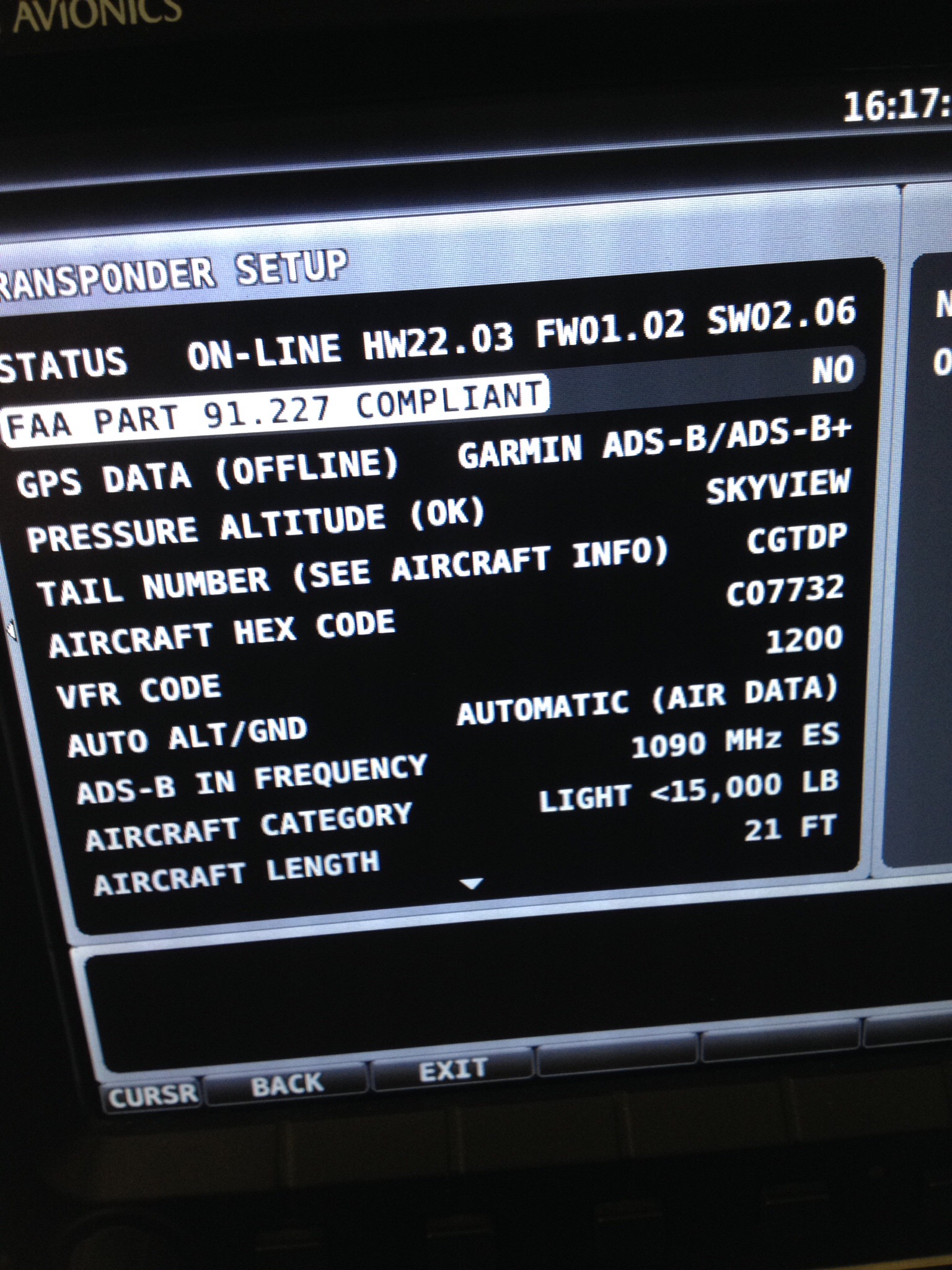

Have the full SV system for the last several years, including two screens, 261 transponder and also garmin GTN650 hooked up. I just recently helped a friend finish up his installation of the exact same system (except garmin).
Went for a group flight the other day, and a third flier using foreflight and Stratus II told us that my he could see my friends tail number on the screen but not mine, he told me he has never seen my tail number while flying. I am assuming that since we have the same setup, the observation on the fore flight should be the same. Settings are the same, I am wondering if anyone has any potential fixes.
Assuming that your GTN was on when you took this picture - notice that your GPS DATA line says (GPS OFFLINE). This means that the transponder isn't seeing the direct serial data connection from the GTN with the ADS-B+ format data that it needs to see to enable ADS-B Out. So effectively, you're not transmitting your ADS-B Out position, and that's probably why you weren't being seen.
The most likely reasons for this are the direct GPS position wire not being connected between the GTN and the transponder. Or, the relevant GTN serial port may not be set to the ADS-B+ format (you need the latest GTN software for that option to be available). You're also probably getting a yellow "CAUTION" alert under button 8 on the SkyView display that expands to "XPNDR GPS IN OFFLINE" when you pull up the detail by pushing button 8.

Thanks, The reason that the GPS signal appeared offline is that I took the screen shot in the metal hangar, no signal. I am pretty sure that the garmin is not the issue. This was still a problem when the SV GPS was used for the signal prior to the GTN installation.
