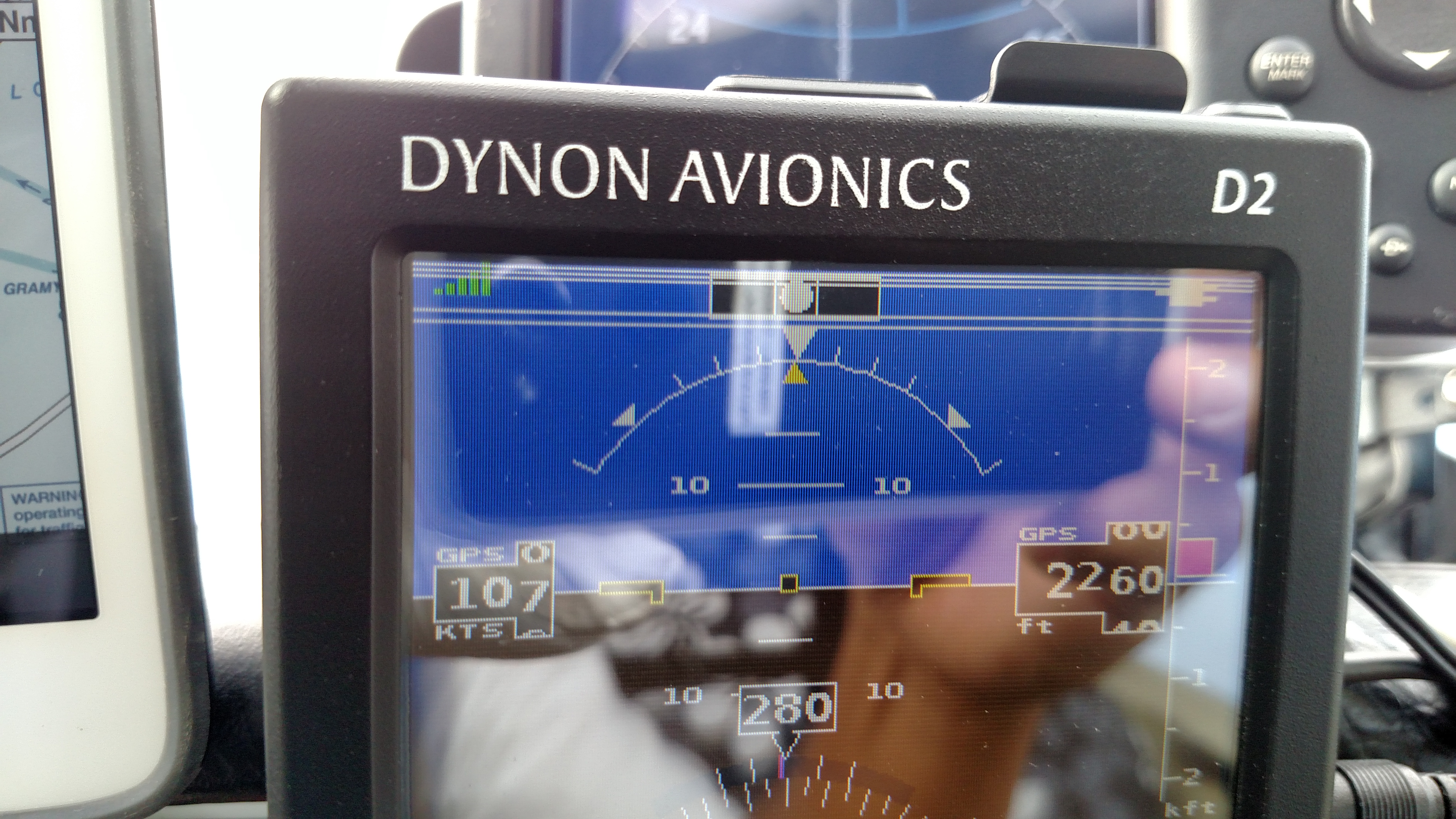

I also have a new Dynon D2, 32 days old via Aircraft Spruce and it just developed white lines across the top.
Also included that in my email asking for support, today.
See picture attached.
