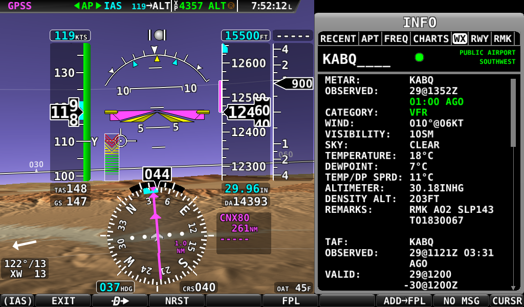

I have noticed that every time I am flying to Albuquerque during the summer and go to check density altitude on the weather page provided by the ADSB reciever it is not correct. During the summer months the density altitude at ABQ is almost over 10,0000 feet, but the ADSB page is reporting only couple hundred feet. I notice density altitude seems to be correct when flying to lower density altitude fields. is this a bug in the FAAs ADSB or one in the Dynon software. I have attached a screenshot from the last time I flew up there. Thanks for the help, love the latest release of software.
Vince

Thanks Vince. Within an hour of this happening (when you're back on the ground) any chance you can grab us a data log from your display? Instructions are here. In the message area, put a link to this thread.
Actually nevermind my last request. Turns out we have a known issue here that will be addressed in a future software update.
