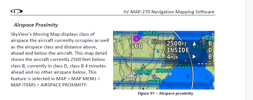

I have dual HDX's.
I normally have the full MAP mode selected on the co-pilots side of the cockpit.
I have noticed a shaded box located in the upper right corner.
The box has four rows of dash lines.
There is no information on the dashed lines.
What information should be in this space????
