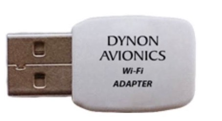

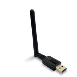

The ADS-B module dies not transmit a Wi-Fi signal, but if you install a Dynon Wi-Fi adapter to one of the USB ports on the back of the HDX, it will send all ADS-B data to your tablet. Note that if you have multiple HDX units, an adapter is required to be installed on each one.
