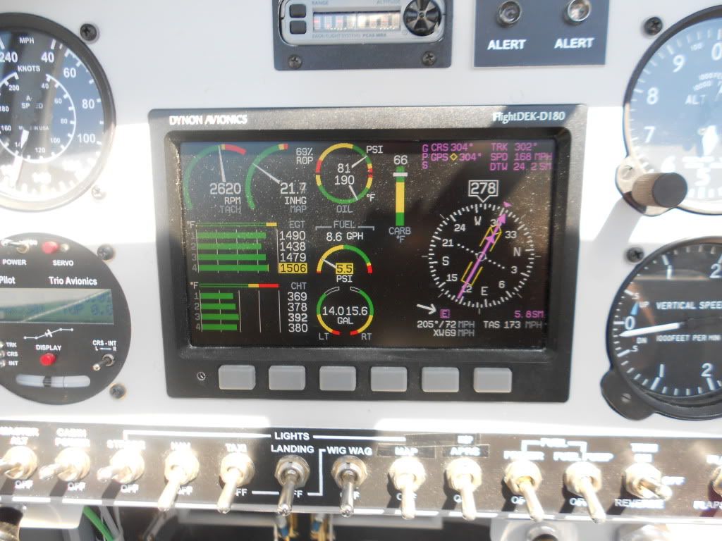

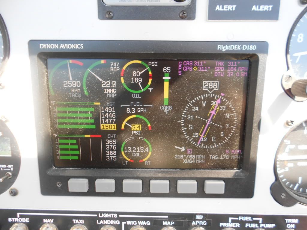

I've had my Dynon for quite a while but my first flight wasn't until Memorial Day of this year. I'm seeing a very odd problem. Look at these pictures:
I was flying directly toward the waypoint in both pictures. The Dynon is showing CRS, TRK, and GPS all essentially the same. The thing is, see the huge difference between the magnetic heading and the ground track? This is causing the Dynon to think that there is a huge crosswind when there isn't. I've calibrated the Dynon on a compass rose already and did the inclination and magnetic field set up as well.
I'm thinking there is a problem with my remote compass. Thoughts?
