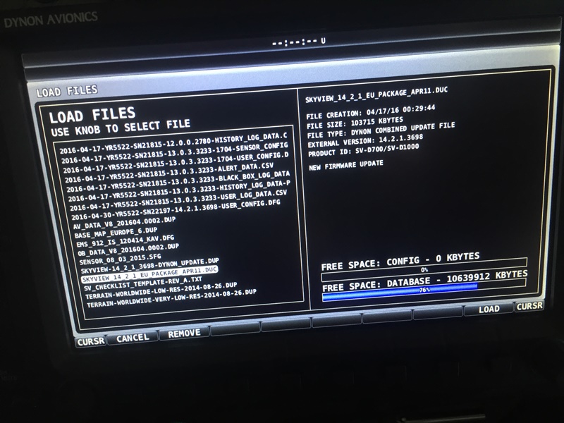

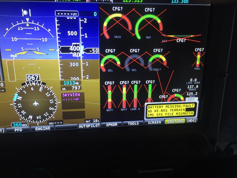

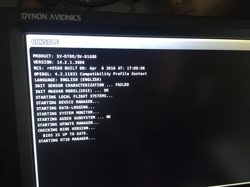

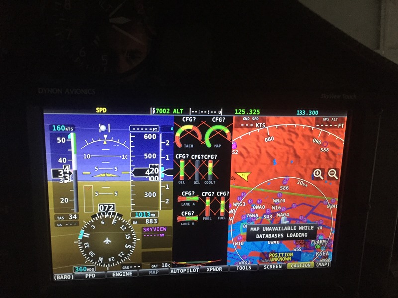

Hello,
After updating the skyview to 14.2.1 version, one of the 2 systems got a config free space problem. As a result, EMS config files are not saved, and also all the settings are lost after a reboot. Reflashing one more time doesn't solve the problem.
Can you please advise how to solve it?

Please contact Dynon Avionics Technical Support - support AT dynonavionics DOT com. We will ship you a special USB flash drive and procedure which will fix this problem.

Can you explain why something like this would suddenly happen to a stable system that is just being updated? :)
The update didn't go perfectly and one of your files is corrupt. When we update a system, we have to change just about every file inside it and very rarely something goes wrong.
