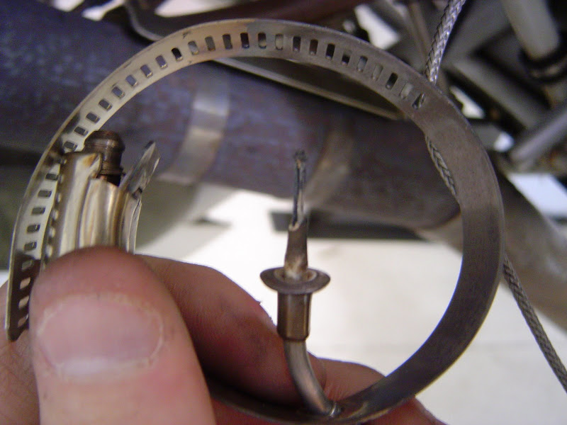

Here are some photos of the burned probes:
This was the one that failed completely.
This is how the other three look.  They all still work, but with less accurate readings that the new probe that I replaced (I had already ordered a replacement probe without checking the failed one first).
2" from the head is pretty close. What temp were you seeing at cruise?
250 hours is pretty short as well, we've heard of them burning up before, but it's generally quite a bit longer than that.
You can use any K-type thermocouple, so if you want to try a different brand, they will work fine with the Dynon system.
