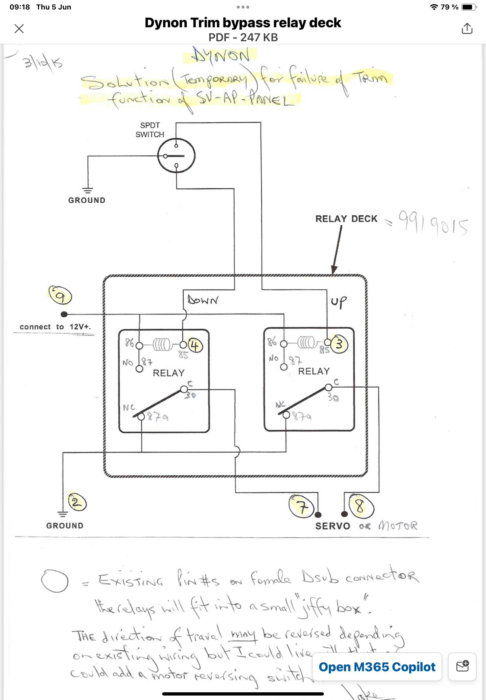

A while ago, before the SB, I had several customers with issues with the a/p panel. My temp solution to enable them to fly was to make a plate, same size as the panel, & mounted a biased switch on it to just control pitch trim servo (pitch was all they really needed) while the issue was being worked on - simple & no need to mess with anything else 😉

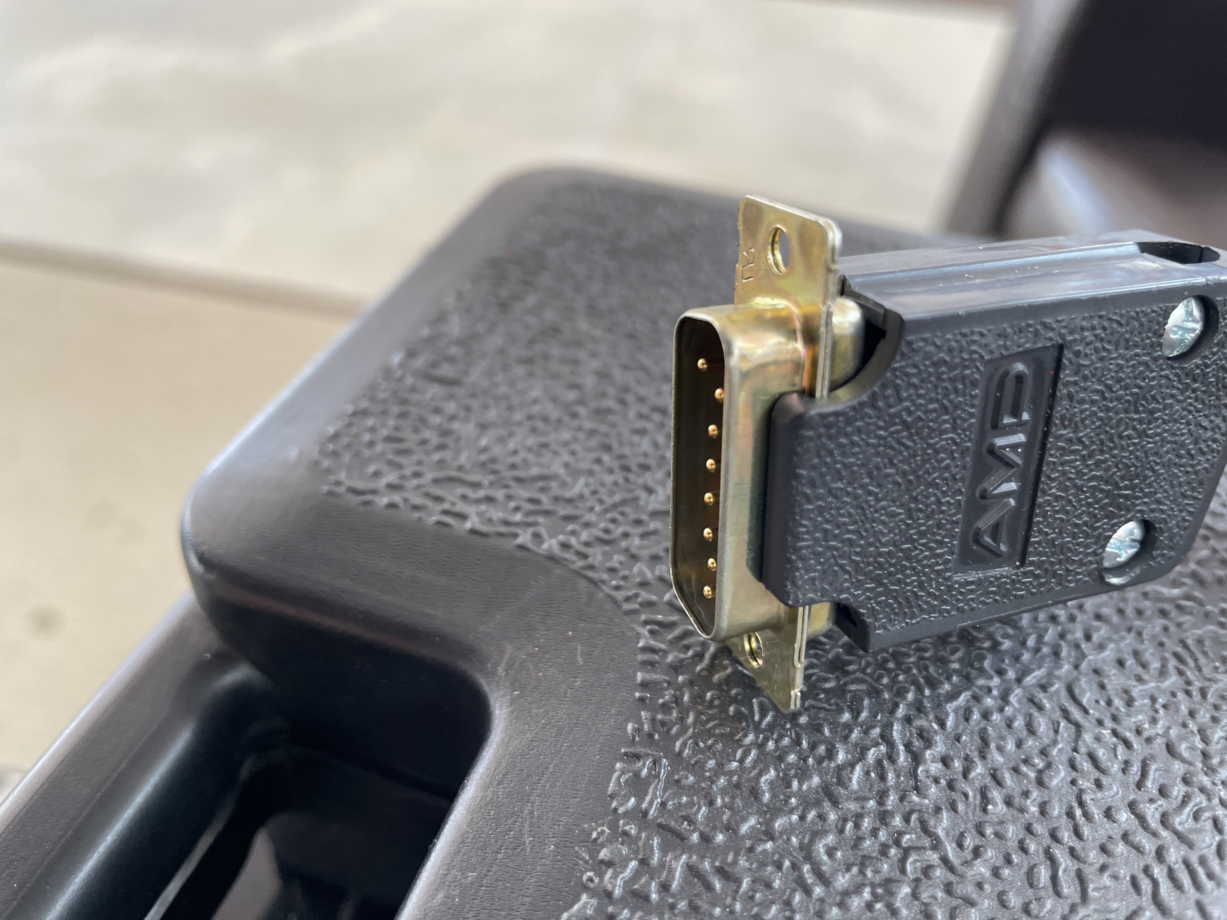

I will disconnect the 15 pin connector and insert D-Sub male pins in it to connect power, servo and hat-switch.

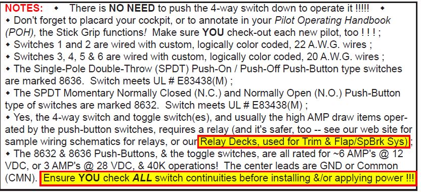

I have Infinity stick grips in my airplane and had a similar relay board before I installed my AP panel which now serves that function. I agree that a relay board is a good idea for a permanent or even a semi permanent flying installation. That said, know that if all you want to accomplish is testing then the Infinity paperwork notes that the switches are rated for about 6 amps for 12V / 3 amps for 28 volts. See the last bullet point:

OK, thanks for the reminder.
If I read correctly, the Infinity hat-switch can handle up to 6 A.
Knowing that the Ray Allen servo pulls about 800ma, to further test the hat-switches, I could jump connector #9 (+12v) to, say #7 (motor) then jump #3 (pilot up) to #8 (motor).

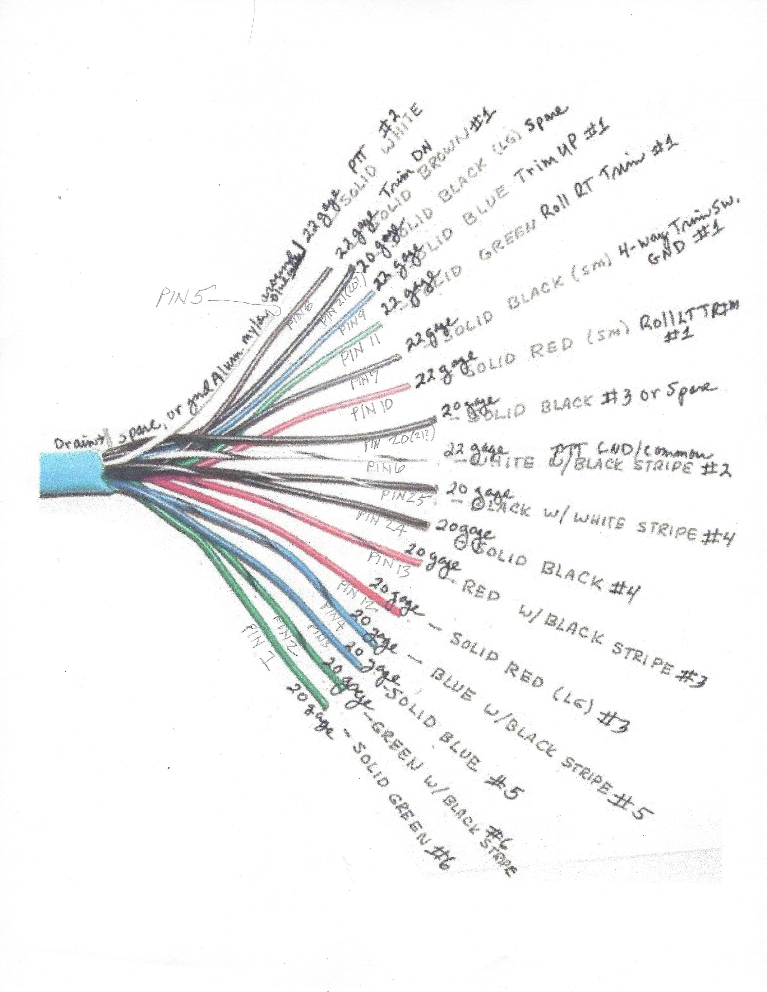

Sorry, the pin numbers you cite sound like the leads for the Ray Allen trim motor, for which I'm clueless. My trim is via a surplus 24 volt Globe gear motor being run on 12 volts to slow it down.

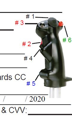

The attached pictures document which buttons on the stick connect to which wires. The #1 refers to left side stick. Prior to adding my AP panel control of which stick (left or right) commanded the trim was selected by a switch on the panel in order to keep the relay board simple. The autopilot on / disconnect have since been added to button #6. The pins in pencil refer to the pins in the 25 pin Dsub connector I use to connect the lead from the stick to the rest of the plane's inputs.

Riseric, I’ll pm u a diagram of what i use - is easy to follow & uses the existing 15 pin dsub connector numbers so its a plug & play solution & can be kept for future use if ever needed. No need to mess with anything else, just plug into the a/p panel connector.

Thank you Jake for the diagram.

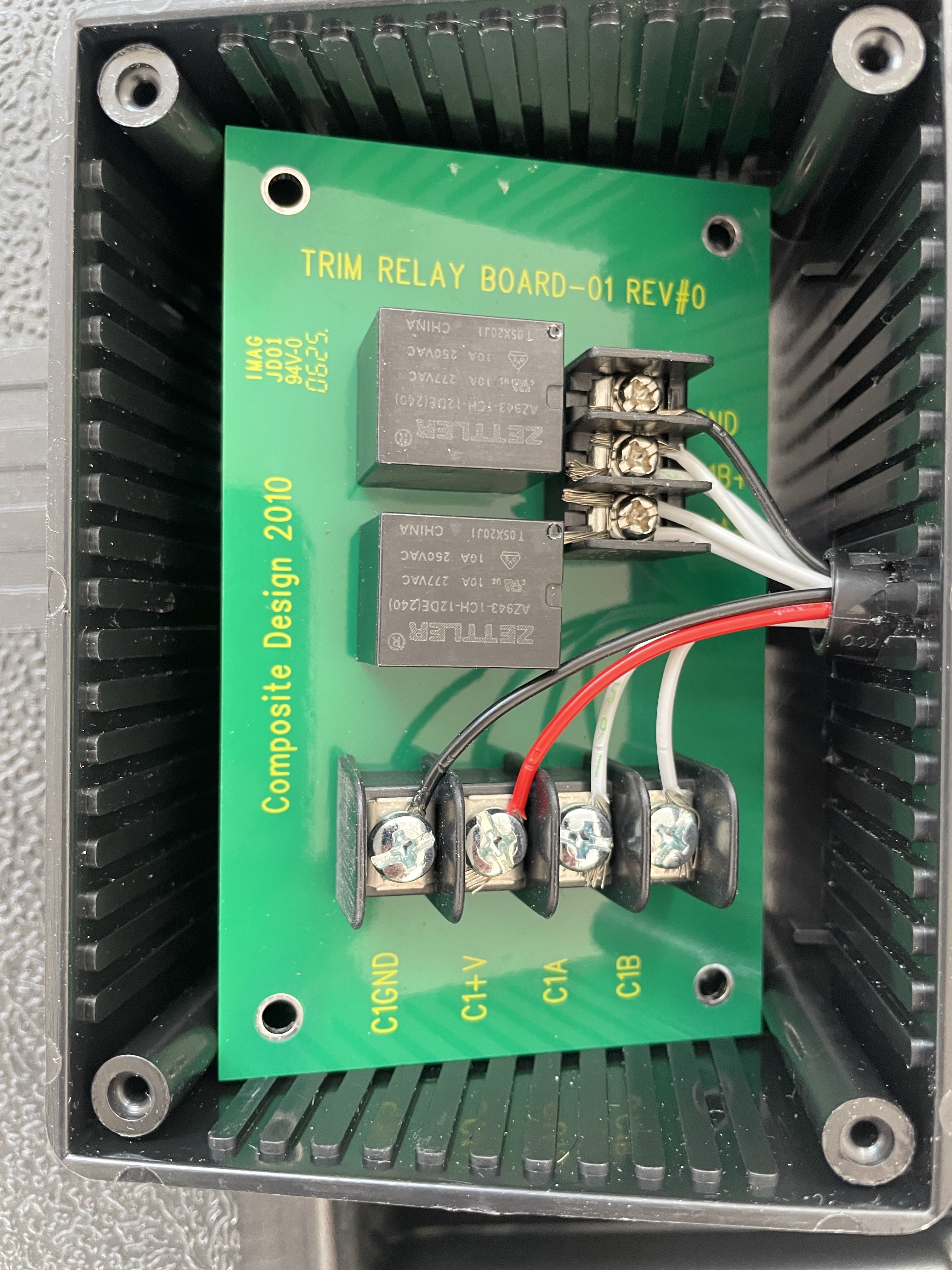

Installed a Trim Relay Board connected to the 15 pin D-Sub that normally feeds the SV-AP-PANEL.
Happy to report that both stick buttons operate the servo-motor in the back.
I now have a temporary fix to the failed pitch trim.
Of course, no Auto-Trim and no 5 second protection.
