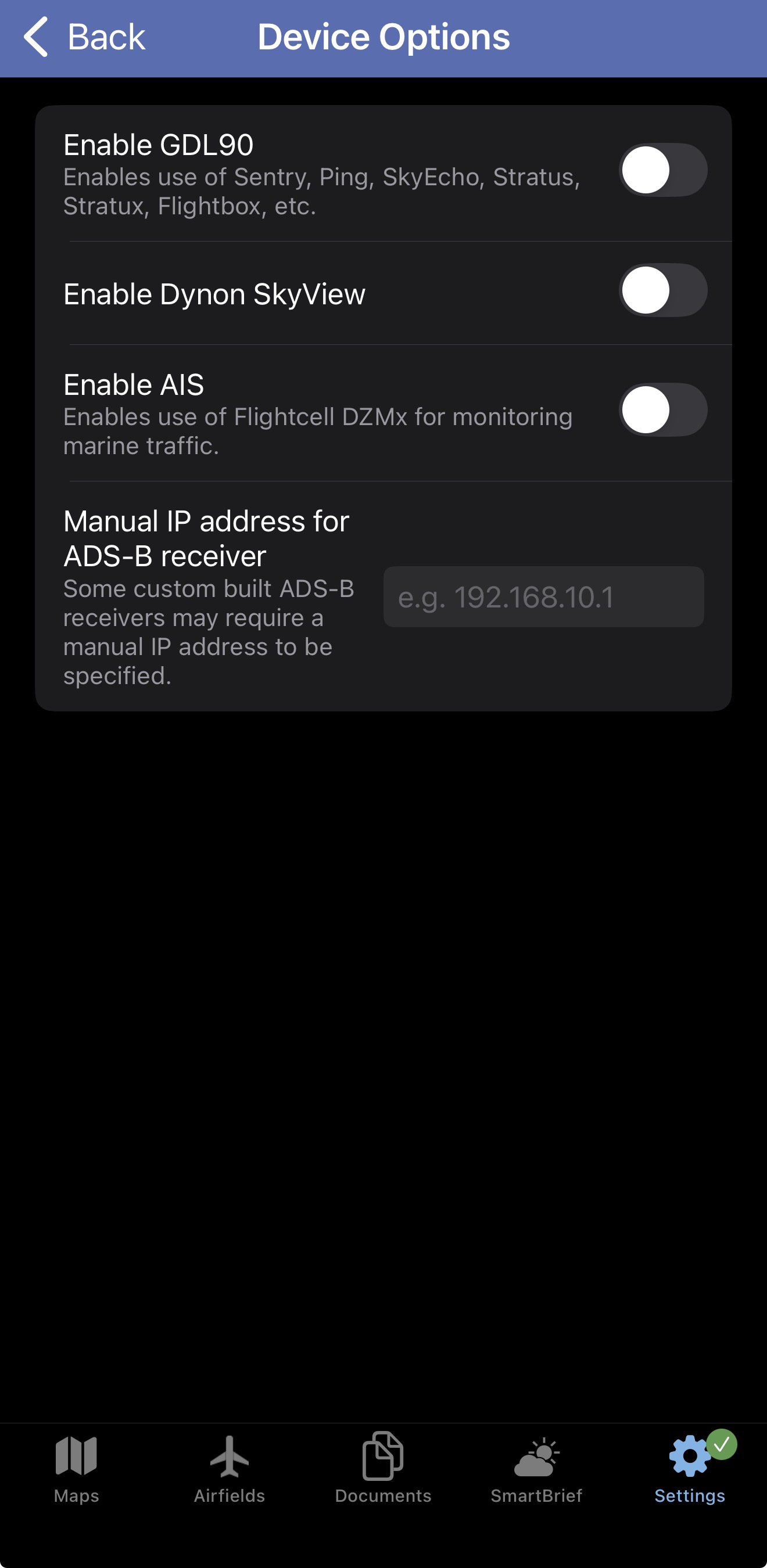

Hello All,
Sorry if this has been asked and answered, but I can't seem to find it.
In my Ozrunways App on my iPad, I have an option that simply says... "ENABLE DYNON SKYVIEW" and I can't seem to find any info on what that switch actually does.
Any ideas?
Cheers
John

No - I am talking about in DEVICE OPTIONS - like this image.
1,844
That enables OzRunways to use your Dynon as an ADS-B source. It tells OzRunways where to get traffic information.

Ahh.. I see. So while connected to the Dynon Wifi, I gather. Does it need an IP address?
