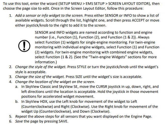

J jask New Member Joined Nov 18, 2020 Messages 5 Jan 6, 2026 #1 When I use the lower band presentation, the right tank quantity is displayed on the left side of the display. Can this be corrected to display the left first?
GKC Aviation Active Member Joined Oct 4, 2020 Messages 184 Jan 6, 2026 #2 Sure can. You can edit the location of the widgets as below. It is in the installation manual
