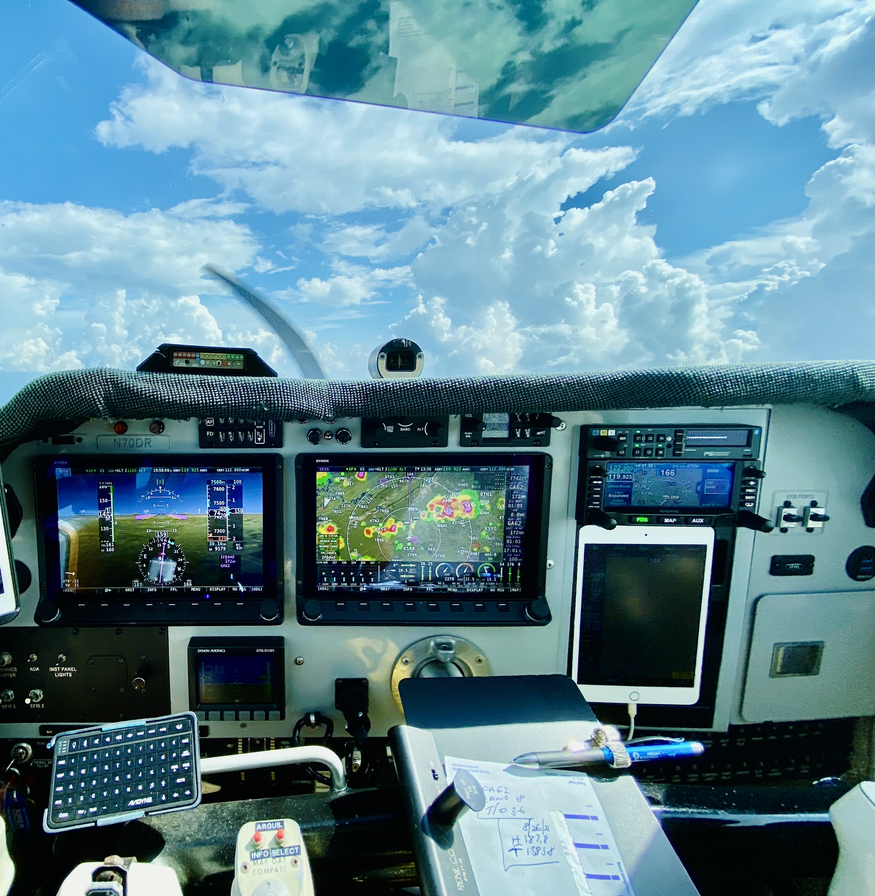

INSTALLED in 2020 - I HAVE A BONANZA V35B WITH TOTAL DYNON HDX SUITE ( EVERY OPTION OFFERED ) WITH 2X10" SCREENS - AS WELL AS AVIDYNE 440 the simplest most intuitive navigator i have ever used.
ALL DYNON
I FLY FULL IFR - ILS -VOR OR GPS APPROACHES WITH AVIDYNE DRIVING THE DYNON SYSTEM
an ipad 4 sits beneath the ifd 440 converting the ifd 440 into a ifd 550 for pennies on the dollar
a wx 500 storm scope is also displayed on the ifd 440
on my yoke there is a small key pad that will drive the ifd 440 if i do not want to reach across to the panel
if i wish to fly vfr with an autopilot -at times -i will select the dynon gps to drive the dynon autopilot for back up / general practice etc
PMA 450B audio panel
