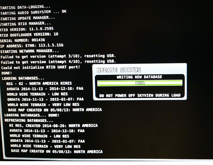

While updating, I saw a message:
"failed to get version (attempt 3/10), resetting USB
Could not initialize RTIO UART port!"
The update appears to have worked.

Here is a picture of the screen

Diagnostic information that we should probably hide as different subsystems start-up and become aware of each other. It doesn't imply anything is broken. If something were actually broken with that subsystem, your knobs wouldn't work.
