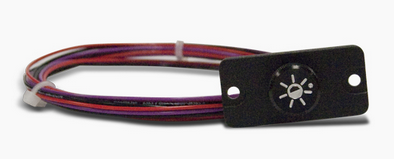

Note that the Skyview really doesn't need a rheostat, just a variable resistance resulting in a variable voltage control towards the Skyview is all that is needed. The external control is just a 10 kohm variable resistance that is connected between gnd and 12 Volt and the variable output voltage really doesn't draw any current. A rheostat might be much too coarse. You could use any variable resistor and just need s space for a single (tiny) know on the panel, but if you want to use the Dynon provided dimmer 'module' it is only about 20 x 40 mm in size.

No difference with the Classic. Using rheostats was discussed in that thread I linked. They'll probably work, but the results may not be as good. As maartenversteeg noted, you can use the SV-KNOB-DIMMER for this purpose, but it costs more. The member in that other thread didn't use it because his panel space was extremely limited, so even the SV-KNOB-DIMMER wasn't suitable. Plus, it cost him a lot less to use his own potentiometer.
