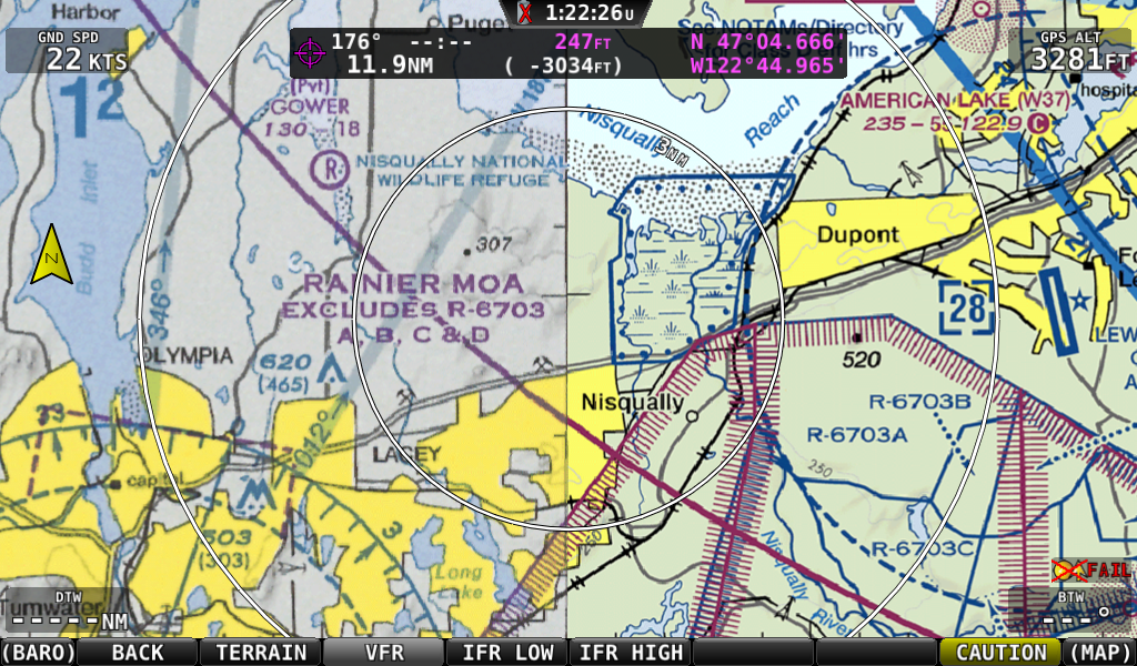

I am not seeing the digital quality on the Dynon or Wing X Pro charts, but it is showing up on the Fore Flight charts. Does anyone else notice this issue? :(

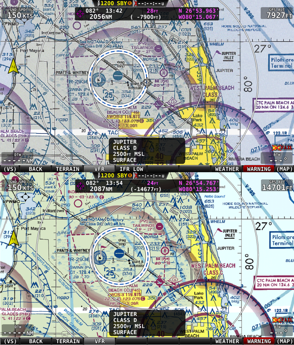

We used the Florida sectional when at SnF. It is up to date for sure. Delete your Florida.zip and it should update.
Here's a quick screenshot, taken off the same SkyView before and after I updated Florida on an old stick I had lying around:
