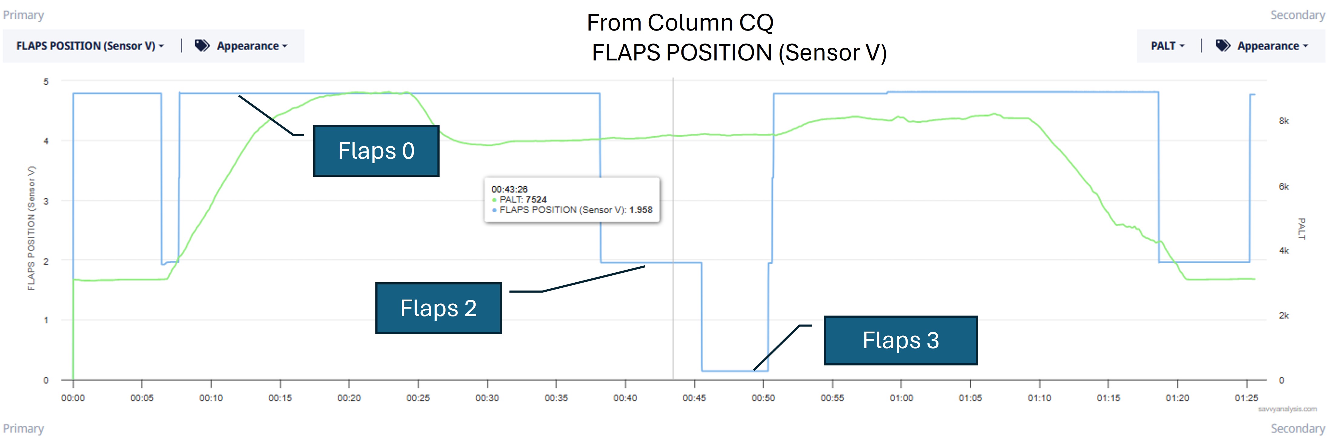

I have a Ray allen position sensor connected to my flap handle. When I perform the flap sensor hardware calibration I get an error that the sensor value has not changed. However when I look at my flight data logs the flap position seems to be reading correctly. Anyone have an idea on how to line up the HDX screen to read the flap position as read by the data logs?
