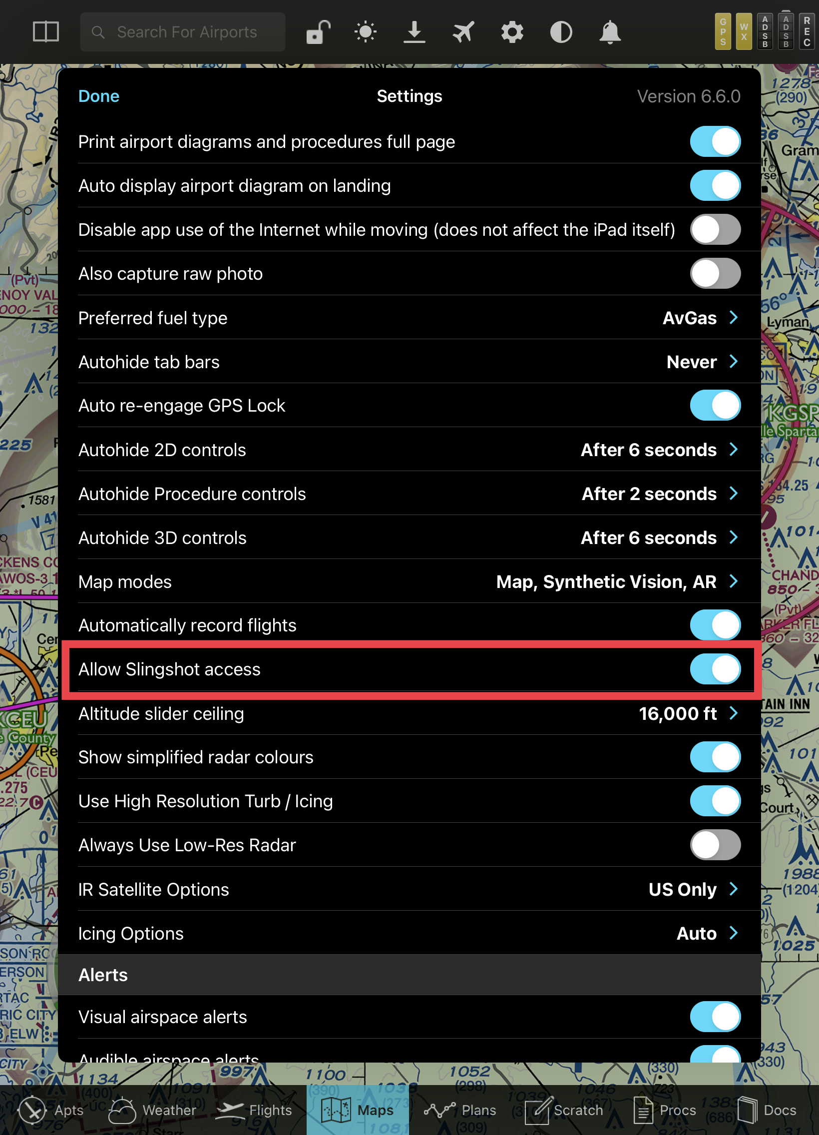

Yes, you need FlyQ EFB to utilize this feature. See attached screenshot from the FlyQ settings menu. I used it once to give it a try, but that was the only time. It takes longer than I’d like, plus if you’ve got dual HDXs, you have to load the database on each unit. I’d rather spend the time at home letting the USB drive update while I’m doing something else than have to leave the master on for the amount of time it takes to load it on the two displays via slingshot. I guess if you’re only loading a couple of states and charts it might be quicker, but for the 13 states I loaded, it took too long.
