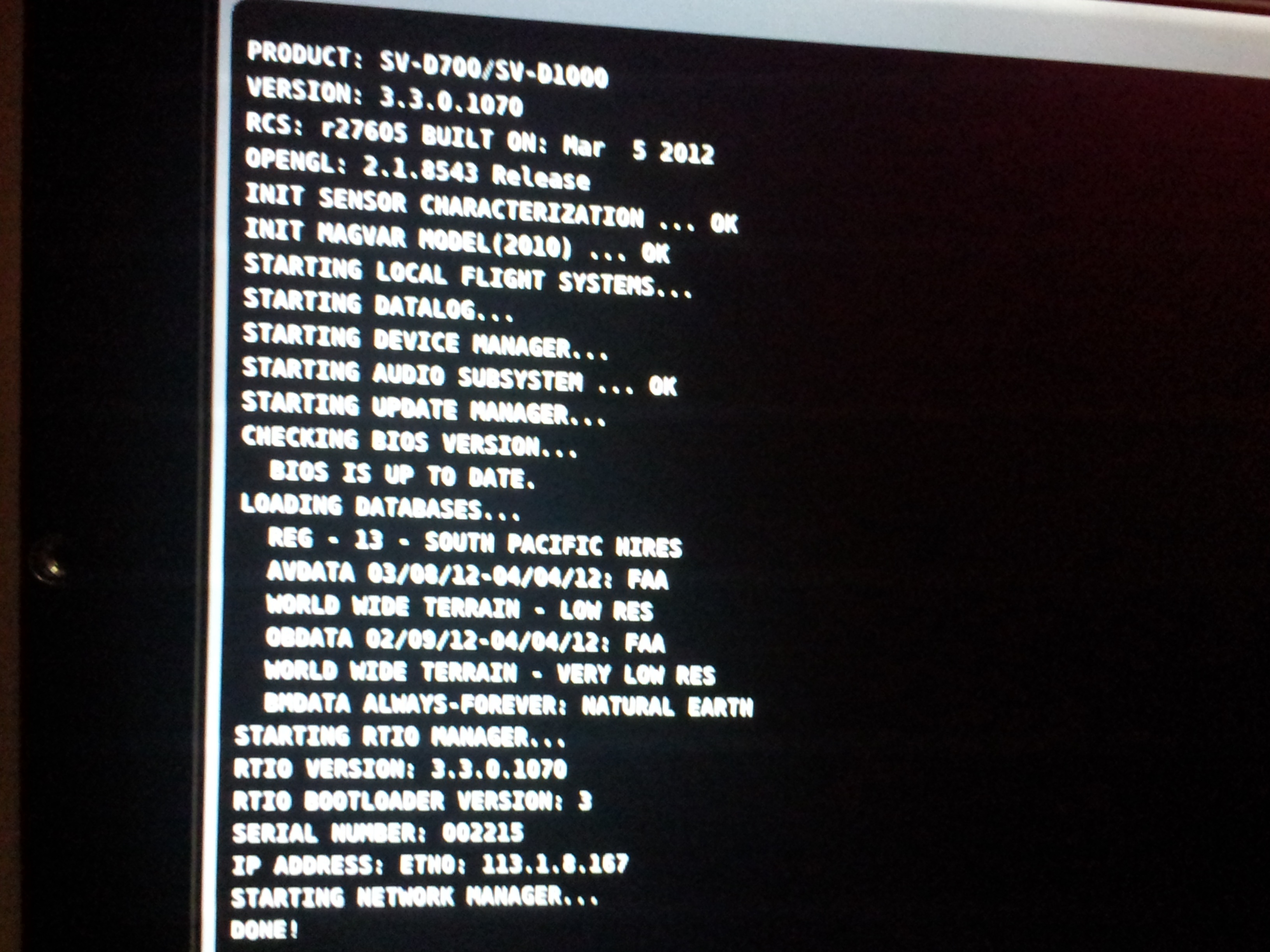

Now the skyview freezes when booting in console mode????
That's not something we've heard of, and given that it is starting to fail earlier in the process, it may be a hardware failure.
Here's what we'd suggest:
Unplug the SkyView Network cables from the back of the screen (the 9 pin ones). Now boot up SkyView and see if it works any differently. If it's still locking up, then you have a hardware issue in the screen and we need to see it.
If it isn't locking up, then you need to see if it's your EMS or ADAHRS that is causing the problem by plugging just one in at a time. We've never heard of a module locking up a screen, so I doubt this is the issue but it's worth a try.
