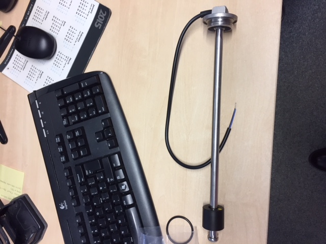

   Back to the calibration - I have 2 sensors but have decided to just use the one like everyone else. First i poured in the 11 litres to fill the RESERVE side of the tank. Next i divided the 60 litres by 12 and got 5. So filled up the aircraft with 5 litres at a time and then pressed the ADD button and FULL TANK on the 12th fill up. When i looked at the fuel widget on the dynon it read 54+. I then drained out 20 litres, as i didn't want to leave it with all that fuel in it and the dynon read 40 litres.......SPOT ON!!
   Also the only values, while filling up, which were the same were the first and last which makes sense as the sender doesn't go all the way to the bottom of the tank and the float was all the way at the top while still pouring in the last 10 litres.

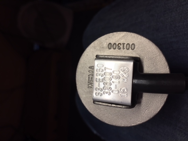

Glad to hear you have had better results with the 18 point probe than I did with the 11 point probe, maybe is't time I bought one.
