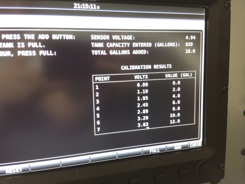

When stepping through SV's fuel quantity calibration wizard, I couldn't find a way to scroll down through the calibration results window. It only shows the first seven calibration points. SV 14.2.1, but this was also present on several earlier versions.
After calibration is complete, you can select Edit and scroll around to your heart's content; this bug is just present while actively running the wizard.
Suggest either making the list scrollable, or displaying the latest seven calibration points (instead of the first).
Does the right CURSR joystick/knob not do anything when either rotating it or clicking it up and down?

109
I clicked, moved, and rotated both joysticks (both say CURSR) and was unable to change anything on the screen.
