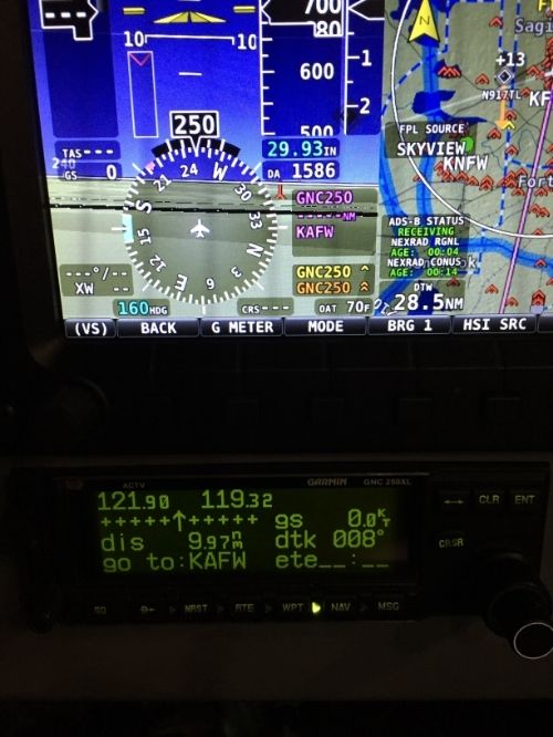

I finally had the chance to get back out to the airplane and try to figure out the Skyview to GNC250XL interface.
As the Skyview Installation Manual shows, the only connections are the RS-232 Channel 1 Output and the ARINC 429 Outputs A & B.  For the RS-232 output, the only options I have are "off" and "aviation".  Obviously, I chose "aviation".  For the ARINC 429 Channel, I have "off", "Collins PL2 EFS", "King EFS 40/50", and "w/o GAMA labels".  I've tried all three settings, and still do not receive any bearing or distance information.  I DO however, receive the identifier of the airport I've selected on the GNC in the small box just to the right of the HSI.
I've triple checked all connections (there are only three wires) between the GNC250XL and SV-ARINC-429 box.
In the picture shown below, I had selected direct-to KCPT on Skyview and direct-to KAFW on the GNC205XL.
Any suggestions?

So, the problem appears to be the input speed selection on the 429 module. After changing it to "Low", the two units are communicating perfectly.
I understand there may not be many people running this setup (it's the best my current budget can manage), but perhaps you could add this info to the next Installation Manual revision...?
The two GNC250XL settings should be: I/O Channel 1 set to "aviation" and ARINC 429 Channel set to "Collins PL2 EFS".
The SV-ARINC-429 Input Speed should be set to "Low".
